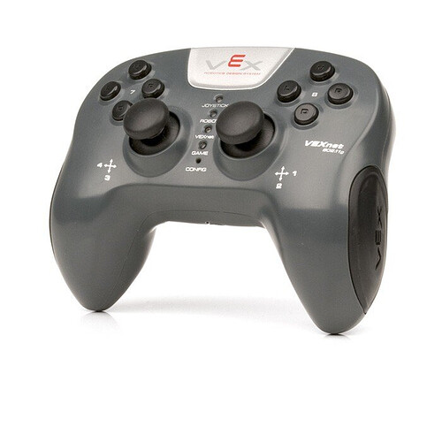

(Vex V4) In our robot, we are using stack lift system for lift cubes. Everything is ok but when i click the button that lift system, robot led on microcontroller and remote controller are being red. The system can lift easily even robot led is red. I looked troubleshooting, but it isnt help. Robot was working yesterday, and there isnt any problem, but today when i try system, robot led getting red

Wait doesn’t the the robot led signify that the controller is connected to the robot? So if it is red then doesn’t that mean that the vexnet got disconnected. Correct me if I’m wrong.
vexnet has its own led light the 3rd down
Oh nevermind the robot light represents the battery life on the robot. So if the light is red then the robot battery is going to die soon and needs to be charged

I thing i explain wrongly. All the leds on robot is green but robot led is red

the problem that you are having is that whenever you are moving a certain part on the robot the controller disconnects. This is not a problem with a motor controller. Motor controllers control motors, but this problem is related to the vexnets, driver controller, and cortex. About 3 years ago my team had a similar problem and by changing our cortex and vexnets we fixed that problem. Do you have any pictures of the robot so we can further figure out why this is happening? Or a video of this incident?

I mean, you seem to still have full control of the robot. Maybe the led is just malfunctioning.
We changed all system. The problem has been solved
