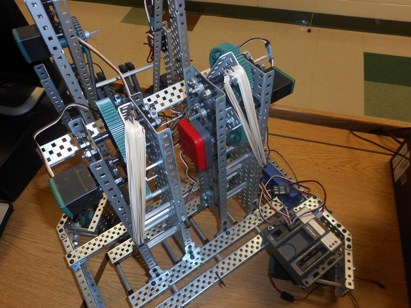

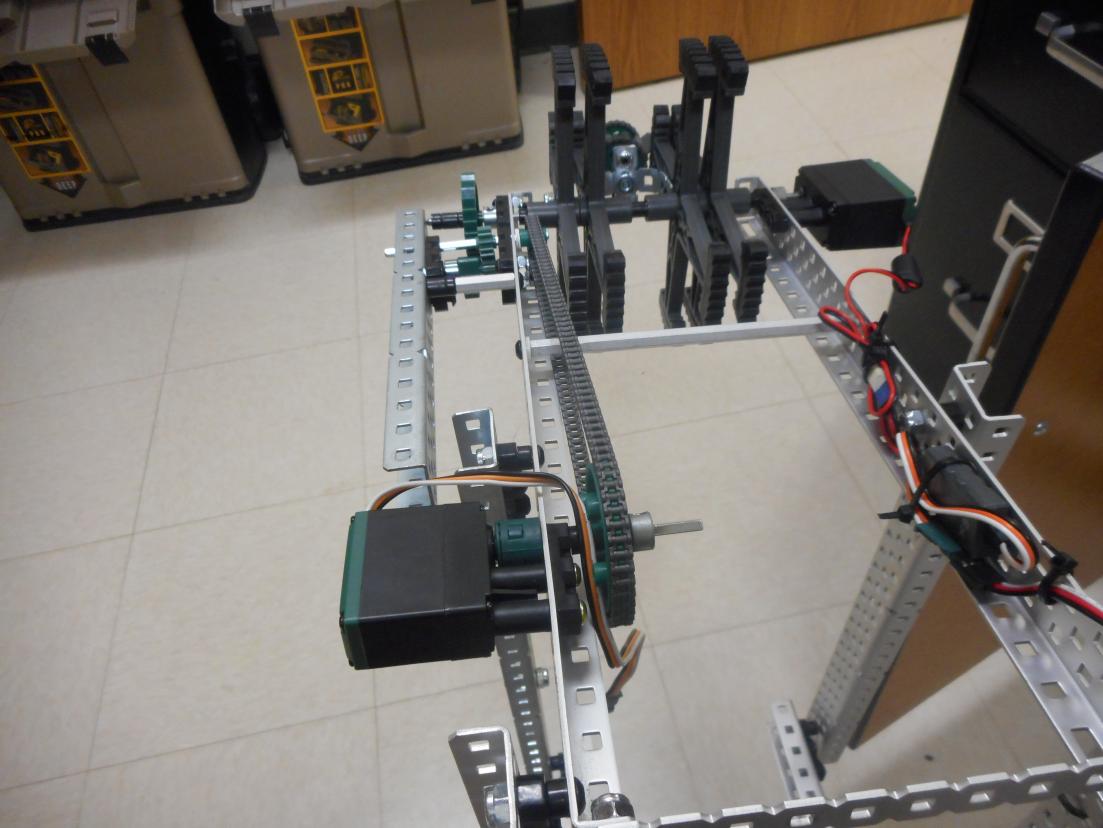

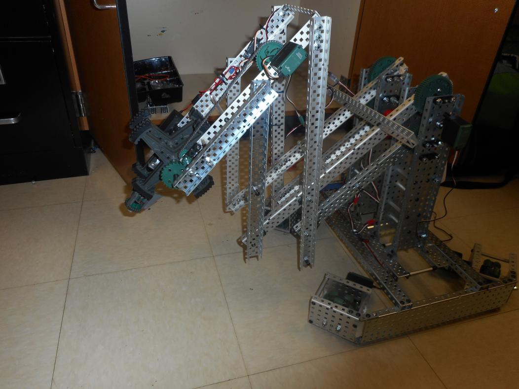

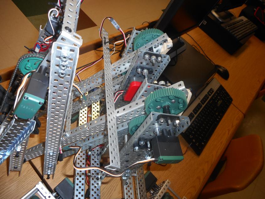

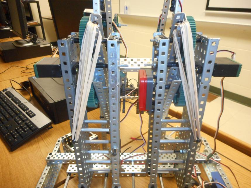

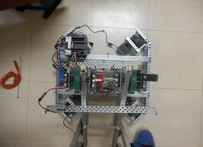

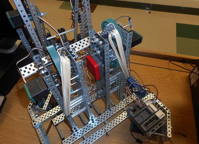

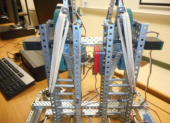

This is our robot
also The code i wrote before I knew about holding the arm at a predetermined position, for some reason only brought the arm down there are servos on the arm right now because i thought about trying that but we were using 393’s
It looks like you have plenty of room in (what I presume to be) the rear of your robot, so is there any way to make an extension on the C-channel to which your rubber bands are connected? If you can extend the effective “lever arm” on which your rubber bands pull, then you might get some better performance. Just a thought.

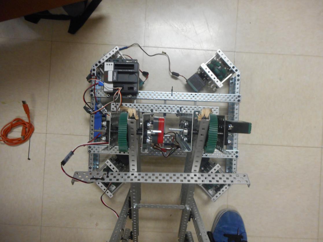

and more pictures

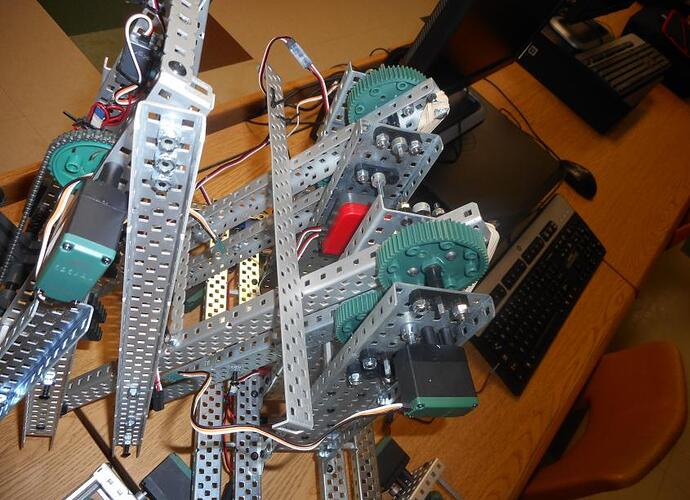

but other wise the arm is gear for torque and at the end for pick up there is a motor connected to an axle that moves the pick up its also something that i would like certain positions for
