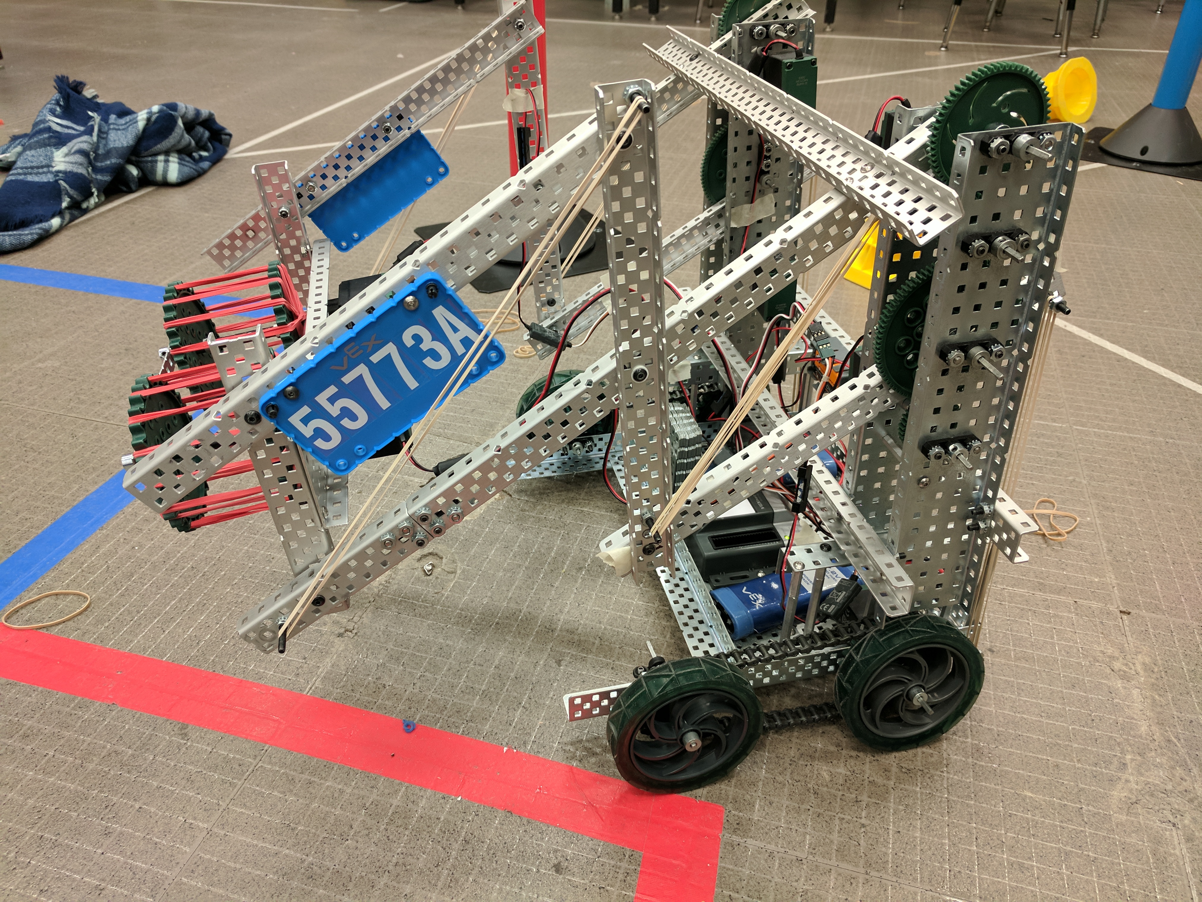

Okay, the rubber bands were a great fix and the lift is working. The only problem now is that, with the rubber bands on, the lift won’t go all the way down and it will exceed the size restriction. When we push it down it goes back to size but if you take your hand off it it lifts back up. Will this be a problem? Are they able to take the rubber bands off for inspection but still use them during competition? I’ve attached a picture so you can see how high it’s lifted.
#15
No since you have to be in 18x18x18 at the start of every match it wouldn’t be legal to take them off during inspection and put them back for a match. One thing you can do is try getting rid of the set of rubber bands closer to the front of the bot and also try moving the point where you have the rubber bands closer together so it doesn’t bounce up as much.

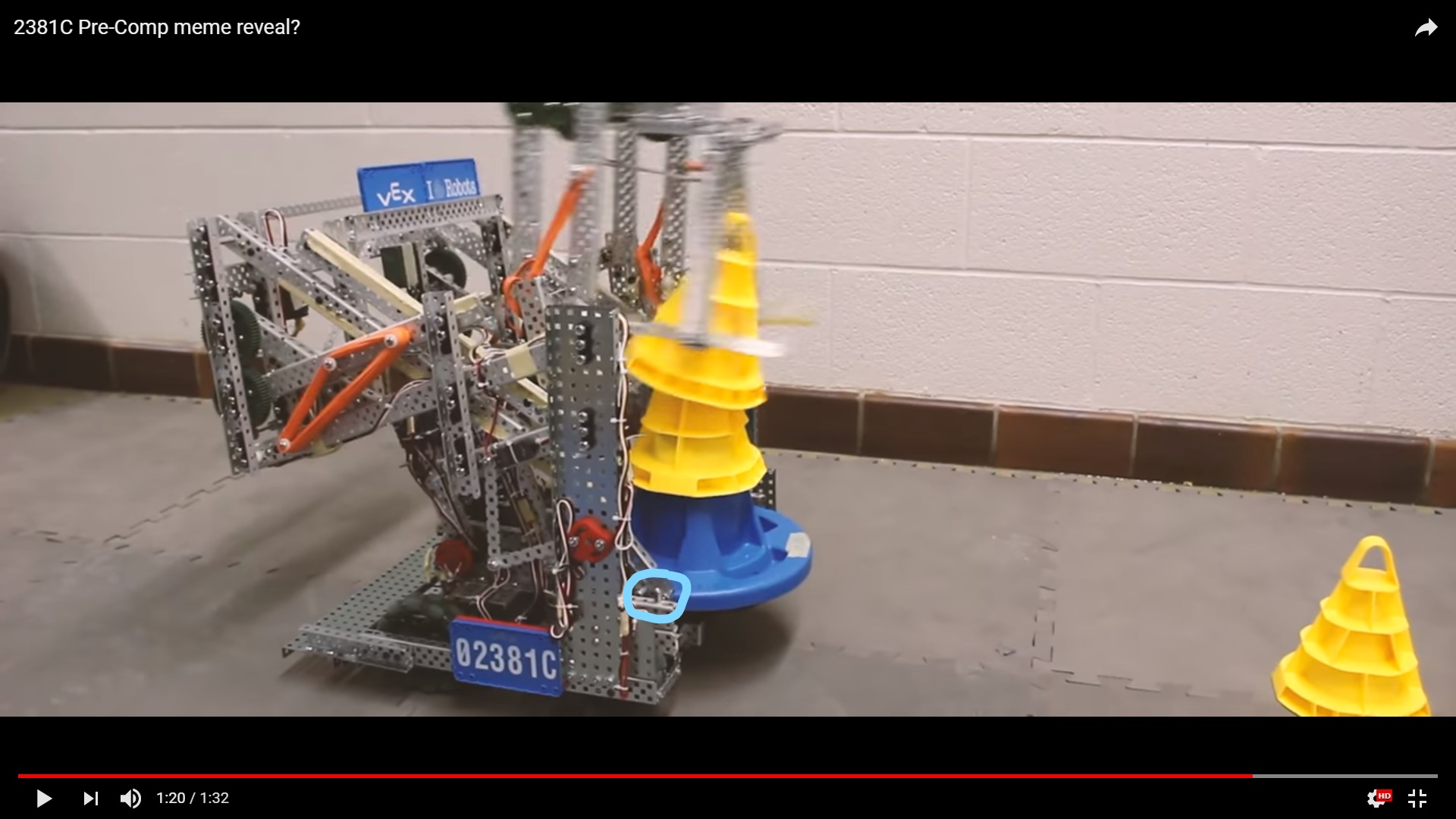

Our team put standoffs on a bar, then used loose zipties to hold the lift down onto the standoffs. Once the lift is released, the standoffs get out of the way and the zip ties just hang.

@JuiceBox I’ve uploaded the video, you can see it from the side here (around 1:15/1:20 in the video)
here’s a screenshot with the standoff circled in blue.
