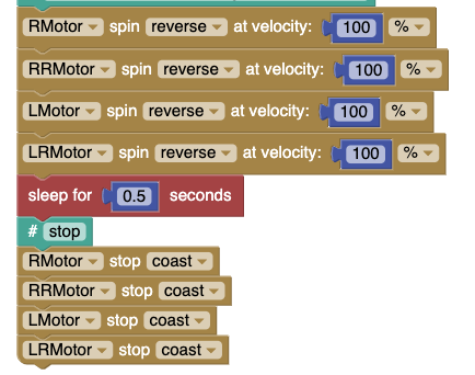

I was wondering if there is any command that allows me to run 2 or more motors at the same time during autonomous. Or if there’s a way I could move my 4 motor drive train all at once since I am only limited to moving 2 motors under “Drive Train”. I am currently programming in Vex V5, Blockly in Robot Mesh. Also if you have any recommendations of any other programming software that is similar to Robot Mesh Blockly then it would help if you could link it or state the website.

Here is a link to a sample RobotMesh Blockly program that moves a robot without the “Drive Train” configuration. https://www.robotmesh.com/studio/5ce07589489e052bc8cb0a7a
It only uses two motors, but could easily be extended to 4 or 6 motors. Like this:
12 AM
