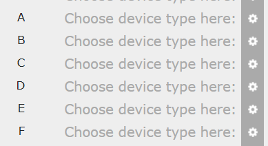

We’re trying to program pneumatics using Robot Mesh Studio, but it isn’t detecting any of the lettered ports on the side. When we tried plugging in a limit switch, Robot Mesh didn’t find it, but the brain was detecting the switch being pushed.
Can you explain what you mean when you say “Robot Mesh didn’t find it”?
Hi Ttr5tt.
Sensors are not automatically detected on non-smart ports, as those ports aren’t smart, and can’t interrogate what’s plugged into them. You must manually configure triport devices by clicking the gray gear icon next to “Choose device type here:”
