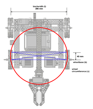

Did you set trackWidth, wheelBase, and wheelTravel when you initialized your drivetrain?
Are you using a gyro ? Inertial sensor ? If not, as @sazrocks said, make sure wheelbase etc. are correctly set, however, wheelbase can be a confusing value to determine, all depends on how many motors are driving the wheels and what type of wheels they are. Standard V5 clawbot with 2 wheels driven needs about 40mm IIRC, a 4 motor/4wheel drive will be different.

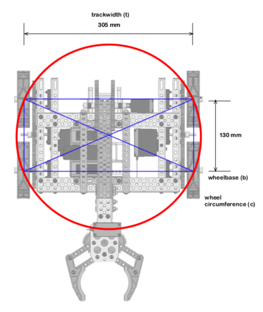

again, it depends on the motor and wheel configuration
This is what happens with a standard V5 clawbot.
center of turn is near the front axle, the front wheels are pulling the back of the robot around.
The old clawbot, where the front and back wheels are geared together, would be like this
Based on those drawings I believe I have my measurements correct.
