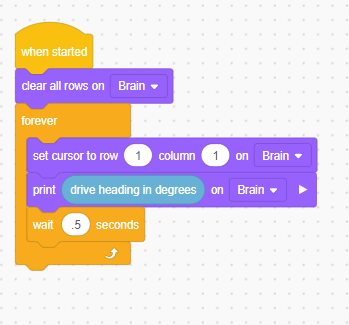

You can add another when started block and use it to output the values to the screen. The brain will run both programs at the same time.
Actually, it might be easier if you use the console. Leave the computer hooked up to the controller and output to the console. Download and then click the Run button on the computer.
