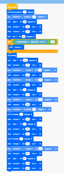

In my code, the robot sometimes pauses, usually before a turn, even though the pause is not included in the code. After the pause, the robot sort of jitters to one side before continuing the code, and it’s messing the whole program up. What might be causing this?

This is the code: image
What part of the code does it usually mess up on? Or is it general to all turns?
There’s no pattern that I can see for when it messes up, but it’s usually on one of the earlier turns.
Each of the drivetrain commands are a “blocking” command. If they don’t reach their target (hit a mechanical stop, too much resistance in the drivetrain preventing it from reaching a certain amount of rotation) it will cause the program to wait until the target is reached - giving the impression of a “paused” program.

You can look at using the “set drive timeout” command to set effectively a “time limit” for each command - it’ll move to the next command once the target is reached OR when the time limit is reached (whichever comes first).
I don’t think that’s it. The robot doesn’t have anything in front of it when it stops, and there’s nothing to block it or prevent the wheels from turning.
