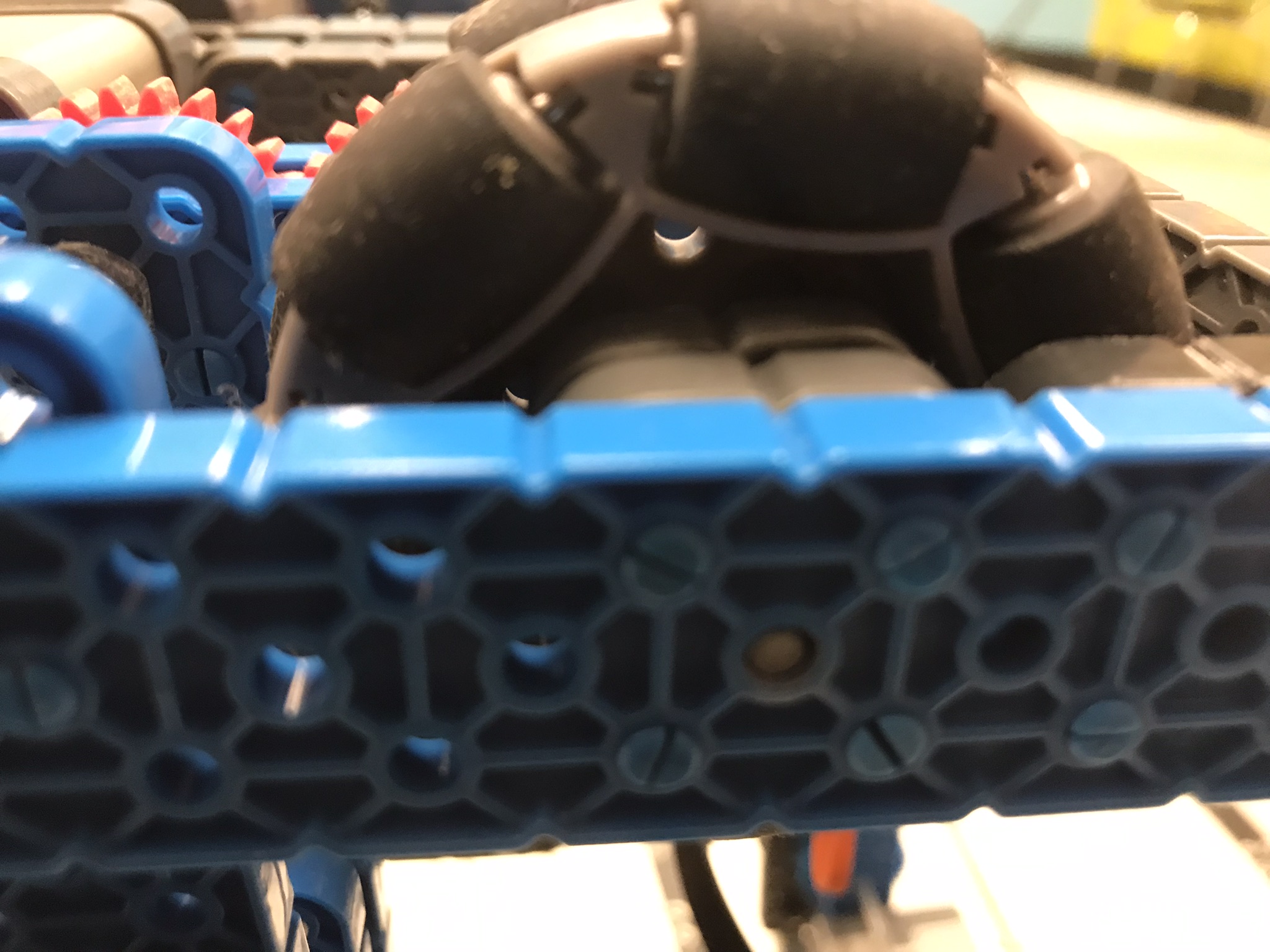

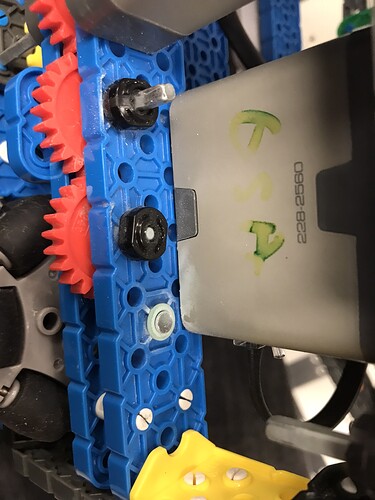

These pictures do show a lot of dust. Like others have said before, there may be excess friction in the system caused by dust build up?
Again restating from above, another possibility could be that the holes that used to act as a perfectly round bearing surface spaced ever so perfectly far apart are no longer perfectly spaced or perfectly round. That dust means material was removed from somewhere and my guess is that it came from the axles making the holes oblong. When this happens, things can fall out of that perfectly spaced distance and cause extra friction because the gears are no longer meshing perfectly.

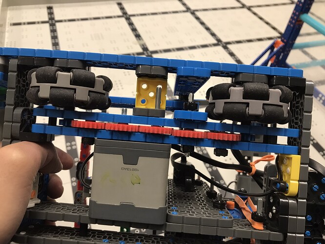

The pictures definitely help. Looking at the drivetrain gears, there are definitely not washers on both sides of the gears. In the first picture you can even see where the gears are not lined up the same way across the gear box. Washers should be on both side of the gears.
Additionally, I’m going to hazard a guess that there are no washers between the rubber collars and the plastic, which will cause a LOT of friction.
Start with addressing those items (and blow out what dust you can when you’re rebuilding the gear box) and see if it starts to address the issue.
Do what everyone else said, but also replace those wheels. They have A LOT of gunk of them not making things any better.
Another potential source of excess friction is that power from motors to wheels is transferred from the larger 36T gears to the smallest 12T gears sitting on the final axles.
It seems to me that with extra friction there is simply not enough torque from a single motor powering each side, which leads them to quickly overheat.
For the drivetrain, I would use direct gear ratio, but if you must gear it up, I would try to pick the next larger gear sizes like 60T to 36T.
