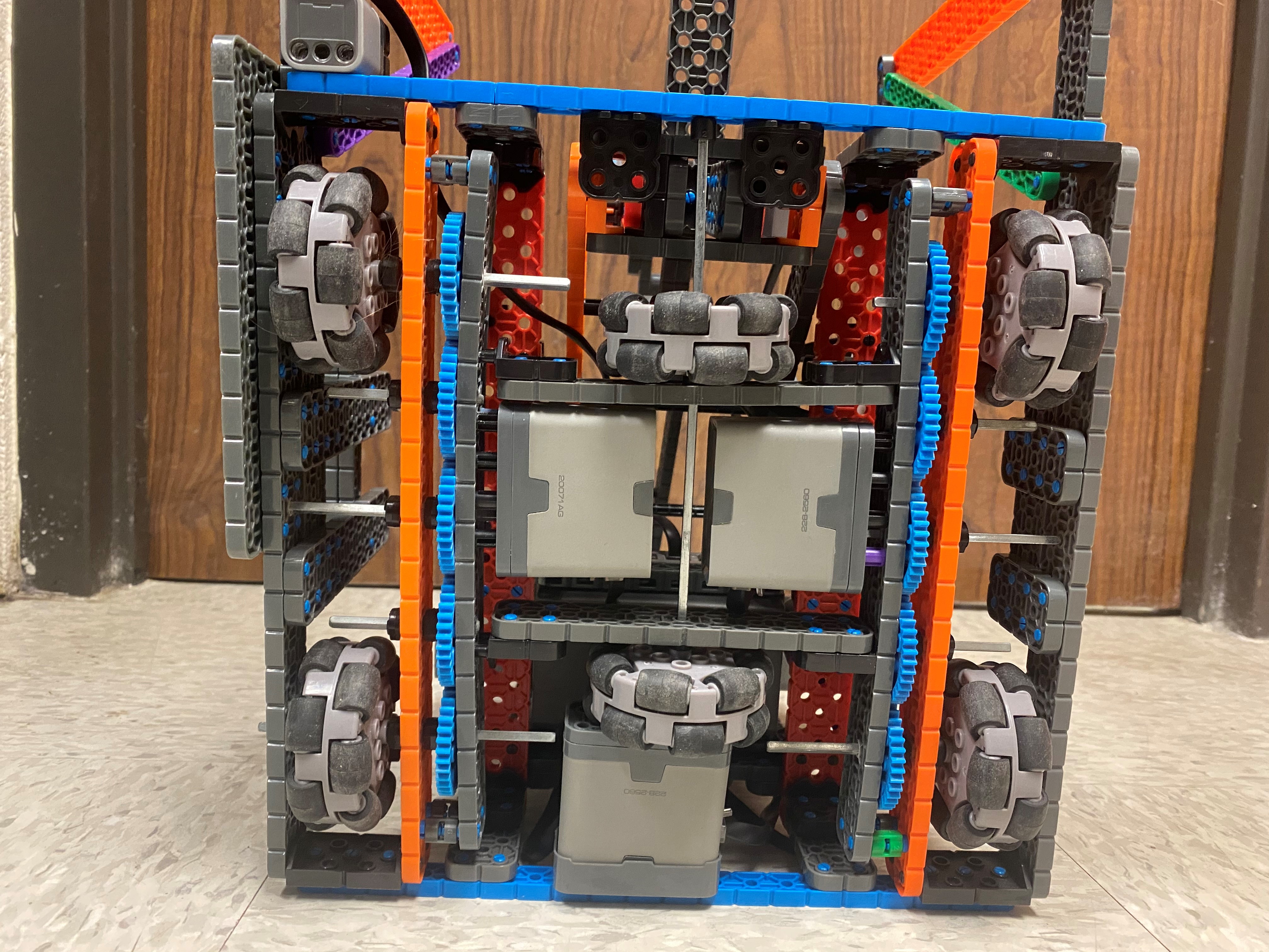

It is very hard to help with coding issues without seeing the code. In this case it also might help to see pictures of the drive.

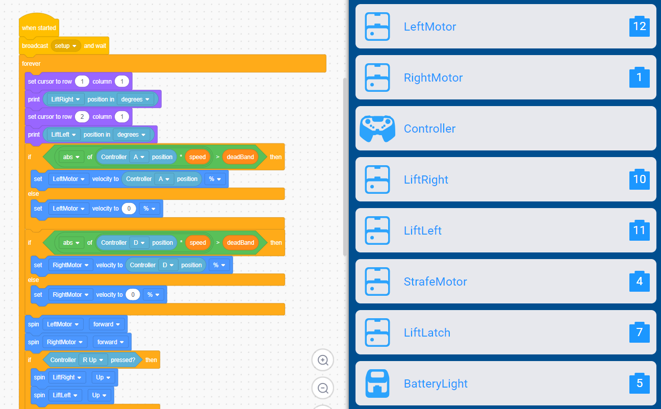

Here is the code for driving. This is not their auton coding.
They systematically changed the brain (thinking it might be a bad port), then changed the motors and wires, then changed the controller. Nothing worked. As a matter of fact, it was still doing it Friday during the day, stopped Friday evening. It didn’t do it all through the qualifying matches on Saturday and then during finals did it and cost them the tournament.

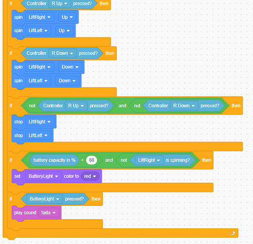

And here is the H-Drive.
Can you post the actual program file?

Given that the team are using a tank drive here, albeit with some additional code to aid their control, the first thing I would do is go back to basics and make a super simple program to test the mechanical, build and electronics side of the robot.
They should do a simple program where they just assign tank control using no code, and just the basic Controller Configuration under Devices to set up the drivetrain control. Then drive it around loads and see if the issues occur. They should probably leave the strafe motor in like they already have.
If the issue doesn’t occur under these conditions, you probably have a code issue.
It might also be worth taking the spin LeftMotor forward and spin RightMotor forward out of the forever loop. You only really need send that command once since you are otherwise controlling it with velocity. Probably not the issue, but there is no need to continually send this command every time you go around the loop.
My first go to for an issue like speed is friction. Are any of the Omni wheels rubbing against the chassis?
It looks like that may be a problem on the strafe wheel, but nowhere else.
