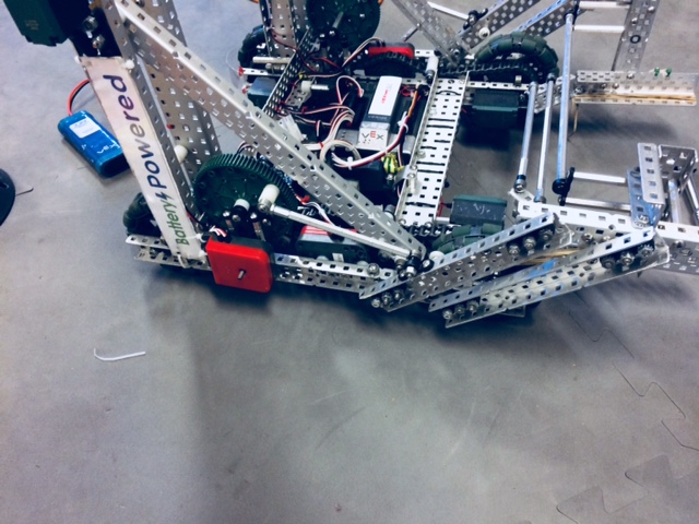

Here we have some on our old robot:
Not nearly as clean as some of the other wiring here, but it took a lot less time also. At least do some rudimentary wire mangement so the wires are not obstructing the function of your robot (e.g. getting caught in mechanisms) or at risk of being unplugged mid match.
General tips include avoiding puttting wires through gearboxes, wheel areas, and other moving parts. Use zipties to create wire bundles and lock them to support bars. Be sure that locked wires will not move as parts of the robot such as an arm move.

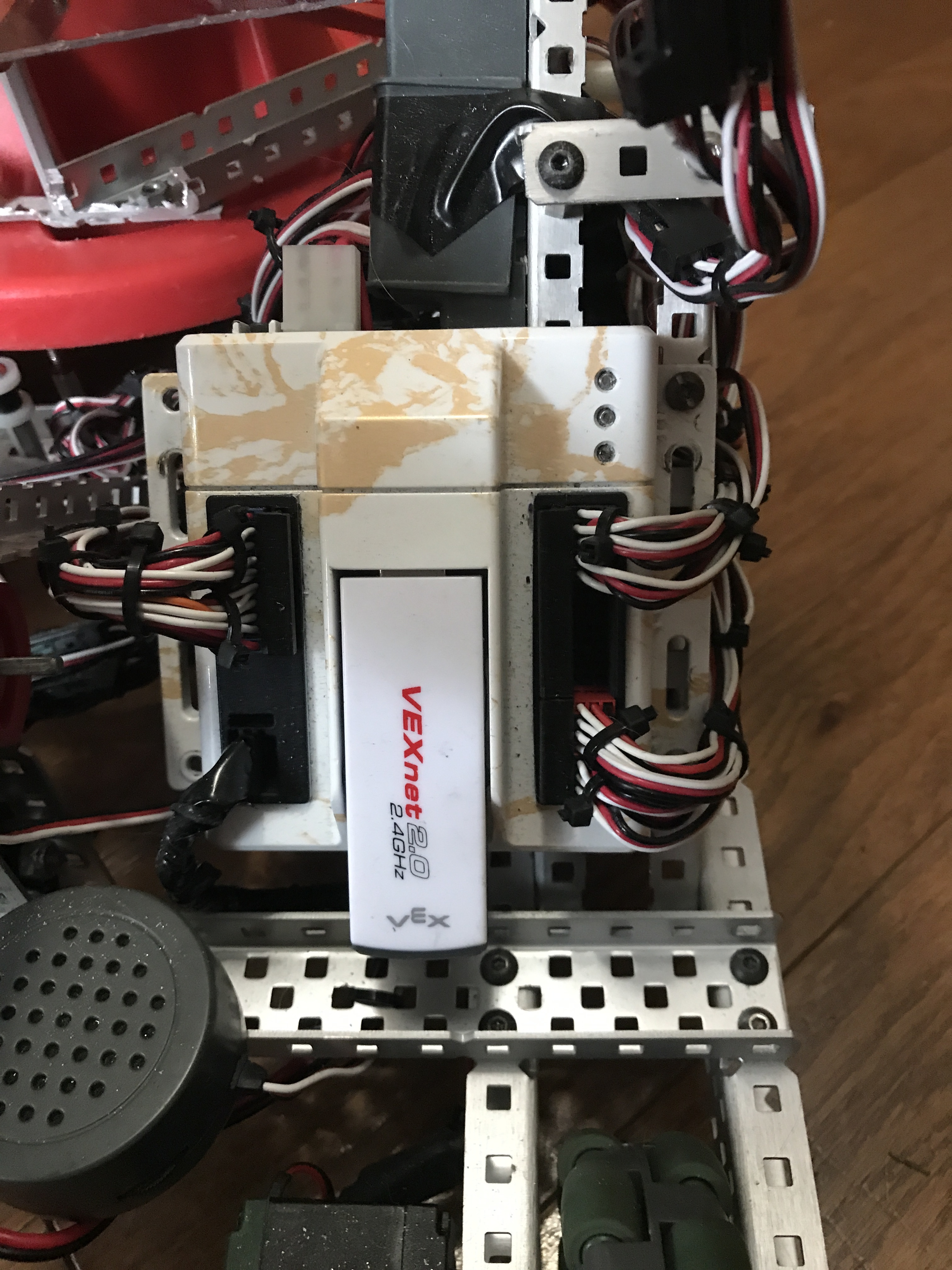

One thing I get scared of occasionally when wiring is that one or more of the wures of the CORTEX or Expander disconnect. When wiring near the CORTEX and especially the Battery Expander, make sure that when you add zip ties a wire doesn’t disconnect from them. If one does try to give some slack to that wire so it doesn’t disconnect again. Another thing I figured out is to try your hardest not to fold the wires too, since it can break the metal inside the wire.
Hopefully this helps :wink:
Also here’s my wiring:
