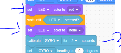

My robot runs the program on one side, but when I take it to the other side, the rest of the program won’t run. Please help!

In general your flow is good. You have it wait for “led” to be pressed sometimes and sometimes it’s “led2”… Maybe you could have the light turn on for it when it’s waiting.
Also I don’t think it will do you much good to recalibrate the gyro in the middle of the program. You are going to burn up those 60 seconds pretty quickly. Reset the gyro at the beginning of the program and then let it be.

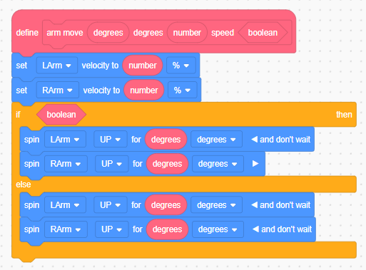

Finally, I would write a function for your arm movements.
This will cut the length of your thread by half and make it much easier to read. This sets the velocity, degrees (make it (-) for down) and if it is blocking all in one line. By making your code easier to read, it will make it a lot easier for you to troubleshoot your problems.

Thanks, it does the other part of the program now.
