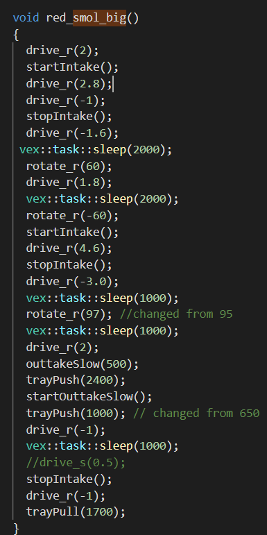

We are having issues with our code in vexcode. When we call the rotation function image into our autonomous function
and run it, the robot will skip over all the rotations until the last one, which will work. We even tried getting rid of the rotation function and just inserting the same code each time we rotate, but it still won’t work. How can we fix this?
