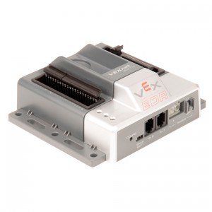

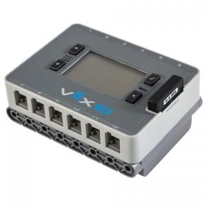

You posted in an IQ forum but referenced the cortex which is EDR. Which platform are you using ?
Thats my bad, honestly im not good with this stuff and im really new so when you say “platform” i dont know what you mean, so Im going to assume the platform i use it the cortex or something like that?
Ok, so this is VexIQ
4-radio_1_4
and this is what in generally know as the cortex.
cortex-microcontroller
so you are trying to use the second one ?
Yes, the 2nd one is the one im using.
