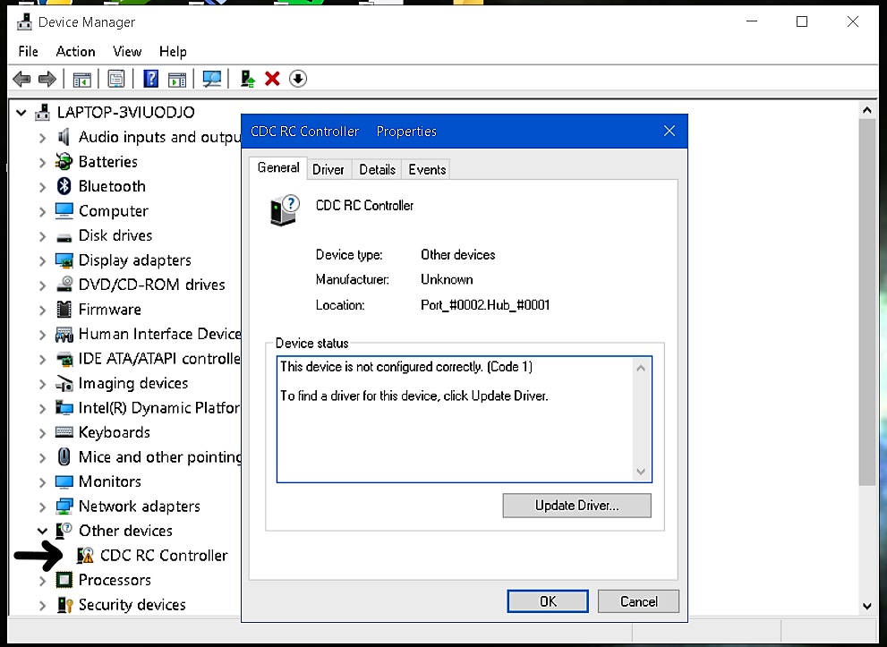

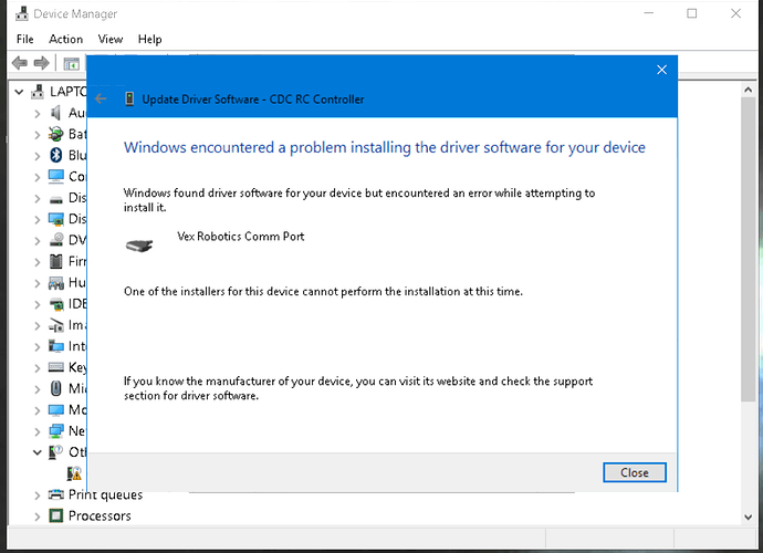

Ok so a quick update on the issue: I found out that when I plug something (cortex or joystick) into my laptop it is getting recognized but they have a driver error. So I tried to update the drivers (with internet connected) and I keep getting an error with that. I also downloaded the driver thing from vex’s website and followed the instructions on it to no avail.

Look in the device manager, what do you see under Ports, perhaps grab a screen shot of that. You need to be able to see the cortex here or nothing else will work.
If the cortex (or programming cable) shows ok in device manager, do a software inspection in ROBOTC and see what that shows, if you can see the cortex firmware version (hopefully 4.25) but nothing for ROBOTC you need to download ROBOTC firmware again manually.

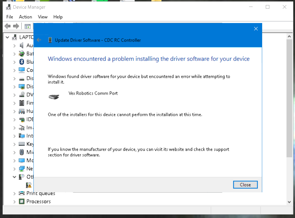

ok @jpearman, so When I plugged the cortex (or the joystick) into my laptop they both showed up in device manager but they had a little exclamation sign next to their name that if I’m right ?indicates a problem with the driver? So I double clicked on it and chose to update the driver but no matter what I try to install on it (I even downloaded a fresh install of the drivers from vex’s website) or if I let it try to auto install something I always get an error(that’s attached as the second picture) when trying it with both the joystick and the cortex.

Well, it’s definitely a driver problem and that’s always hard to debug. Which version of windows is that ? I would start by removing any existing driver for that device and re-installing using the appropriate driver from C:\Program Files (x86)\Robomatter Inc\ROBOTC Development Environment 4.X\Drivers either VEXCortex32 or VEXCortex64 depending on OS. I would install with admin priviledges just to be sure. Until the cortex shows correctly in the device manager as a Vex Robotics Comm port ROBOTC, or any other IDE, will not be able to communicate with it.
You may be able to uninstall old drivers by going to View -> Show Hidden Devices in Device Manager.
@jpearman I have Windows 10.
I tried all these and so far I just keep getting the same errors.

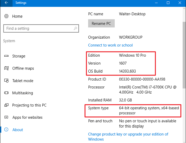

Can you get me the exact build of Win10, look in settings, see attachment.

One of my concerns is that Windows 10 has changed driver signing requirements, but these requirements only kick in under certain conditions, a clean install of build 1607 or later, secure boot on, driver signed after July 2015, perhaps other things as well. We should be ok with these old cortex drivers as they were signed a long time ago, I’m just trying to figure out if a recent change to windows 10 has broken something we are not aware of.
