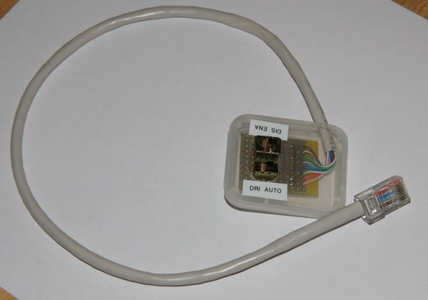

I’ve seen some errors from our kids as well and I pinned it down to having a competition controller switch plugged into the joystick. This did not used to be a problem with last year’s versions of Robot C.
When you take out the competition controller it generally works. (I say generally)
Using v3.04 of Robot C but not sure the version of the prolific driver but it was a new version given to us. It’s a brand new Joystick, Cortex, and set of Vexnet USB keys too. Same old programming cable though but has been shown to work.
(This is the Foster made competiton controller switch and is a bit easier to reset than via software panel in RobotC)
https://vexforum.com/t/vexnet-competition-switch/18158/1
Yes, I have one of those and now you mention it I did notice an issue a couple of weeks ago helping the students download autonomous code, we had to disconnect the switch (an official one) to get it to work. I will look into that when I have a chance.
Here’s mine, old cat 5 cable, some proto board, couple of switches I had laying around and a CF card case hacked with a utility knife.
https://vexforum.com/attachment.php?attachmentid=4798&stc=1&d=1321637223
