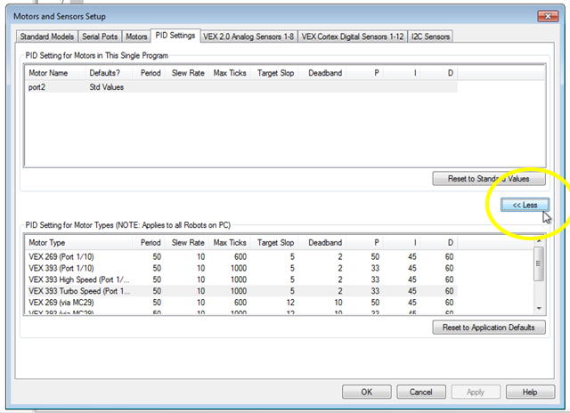

What are the default PID constants? or are there any? i see the menu for PID, but how can i tell what the constants are or how do i change them? is this really as easy as it looks, where you just turn on the PID control and it does the rest on its own?
Actually neither, it’s an arbitrary speed where 0 is stopped and 100 is fast. The actual raw power level sent to the motor will depend on the load seen by the motor. Look in the debug window at the value of “PWM power”, that’s what is actually going to the motor.
This functionality, as I said in post one, was designed for making a robot drive in a straight line (ie. making left and right weeks travel the same distance), it may or may not work on a flywheel.
The default constants are visible if you click on “More” in the PID settings tab (remember, super user menu turned on). It’s sort of complicated to explain but there are system defaults that all ROBOTC programs will share and program specific settings. Double click on one of the list box rows to change for that motor.
IME only with the current versions of ROBOTC, I can fix but probably missed the next release unfortunately.
When i go to the super user menu on the left, i clicked on PID and get a list of things, including something along the lines of mtrPIDKp] or mtrPIDKd]. Are these not just there for reference? Clicking on them does nothing, but to my knowledge those are there so you can read and copy them into your code and then use them. So im assuming this isnt the pid settings tab you are refering to, so any guidance on to where that is?
In motors & sensors setup, select the PID tab.
This shows the motor port you have enabled PID for.
Click on more to show default settings, they are different depending on motor type and which port (with or without MC29) they are connected to.
Double click on either your specific port or a default setting to edit.
