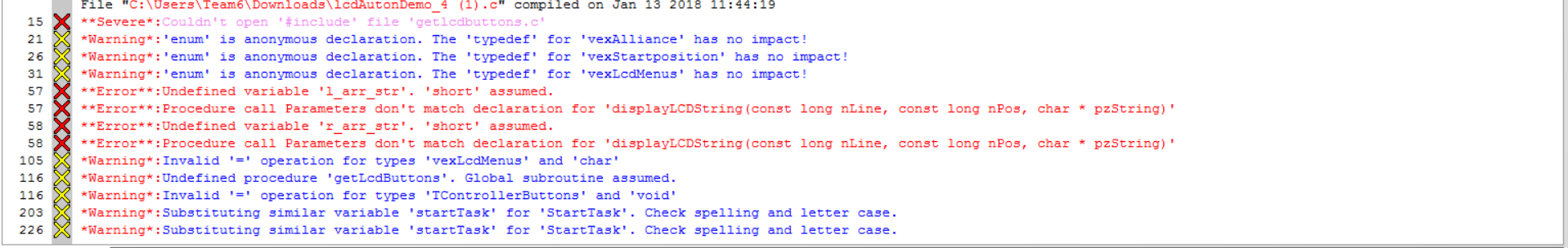

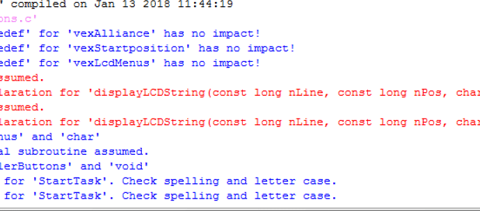

Hi! I tried using some of your earlier codes(Demo 1, Demo 3, Demo 4) and got about 5 obscure errors(the red kind) that I can’t seem to discover the problem with. Do you have any idea what it might be? Our version of RobotC should be up to date… I have attached a picture of the error if that helps.
P.S. The image is for Demo 4.

That is happening because it is not finding the include file “getlcdbuttons.c”. Place your code and the getlcdbuttons.c files in the same folder and try try to compile.
(getlcdbuttons.c was included with The original three demo programs but not demo4)
You will still get some warnings, this code was written over 4 years ago and ROBOTC has changed a little. To remove the warnings, change “StartTask” into “startTask” (non capitalized).
Replace 0 with kMenuStart on line 103
void
LcdAutonomousSelection()
    TControllerButtons  button;
    vexLcdMenus  menu = kMenuStart;
Update the three enumerated types as follows.
/*  Definition of the menus and global variables for the autonomous selection  */
typedef enum _vexAlliance {
    kAllianceBlue = 0,
    kAllianceRed
} vexAlliance;
typedef enum _vexStartposition {
    kStartHanging = 0,
    kStartMiddle
} vexStartposition;
typedef enum _vexLcdMenus {
    kMenuStart    = 0,
    kMenuAlliance = 0,
    kMenuStartpos,
    kMenuAutonSelect,
    kMenuMax
} vexLcdMenus;
Thanks, your advice fixed all the warnings but even after placing getlcdbuttons.c in the same folder as the demo four code, “*Severe:Couldn’t open ‘#include’ file ‘getlcdbuttons.c’” still persists. Any other advice (or something I am doing wrong)?
P.S. Props for fastest Vex Forum reply time. :slight_smile:
Not really sure what that could be.
I would try making a new folder in documents and placing both files there, also make sure that getlcdbuttons.c didn’t get accidentally renamed.
