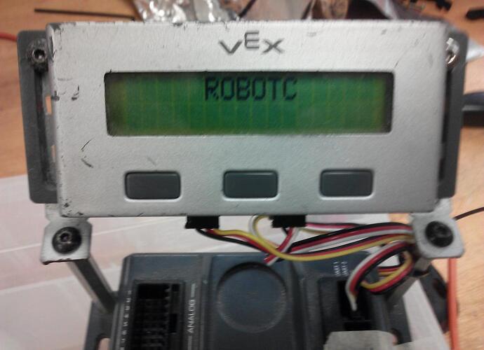

I’m trying to use an lcd display in Robotc but whenever I turn the cortex on while its not connected to a computer it just displays “Robotc” (see attached). However, when I plug the cortex into a computer (as long as the computer is on and awake) it goes to what I actually want to display. I’m not sure why it is doing this.

Sorry about that here is the code. I tried using uart 1 to start with but then tried it on 2 and got the same effect. I also noticed it works when a controller is plugged in instead of a computer.
