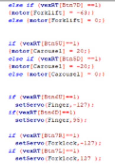

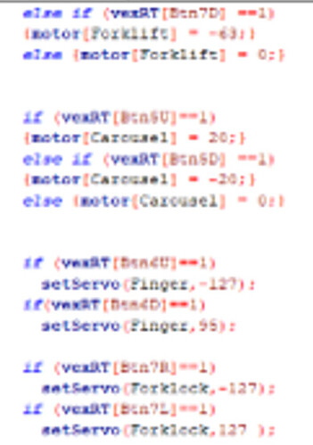

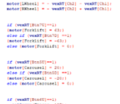

Here is our driving code.
Code screen shot #2 rest of code.
