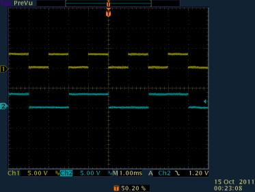

The difficulty in creating a simple multi-tasking example is that almost everything proposed can be done without using multi-tasking, however, just to illustrate the principles involved we will create a very simple piece of code to flash two leds on and off connected to different output ports.
RobotC always needs a main task, this is the entry point for the code, it’s the equivalent of the main function in any C program. From the main task we will start a second task using the StartTask command with a single parameter, the name of the task to start. The call to start the second task is
StartTask( flashLed_1 );
Both the main and flashLed_1 tasks contain an infinite while loop, that is, a loop that never exits until the program is stopped. This loop prevents the tasks from running out of code to execute and therefore stopping. Sometimes allowing a task to finish can be useful but in general I would not recommend it, perhaps we will cover starting and stopping tasks dynamically in another post.
The contents of the while loop of each task is very similar, change the value on the output port and then wait for a preset amount of time, change the output port value back and then wait some more.

Here is the code to play with, if you try this in the PC emulator look for SensorValueSimulations[8] and SensorValueSimulations[9] changing as these represent the first two digital ports.
