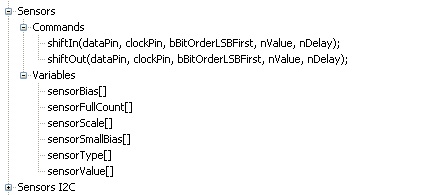

[ATTACH]7818[/ATTACH]
shiftOut(dataPin, clockPin, bBitOrderLSBFirst, nValue, nDelay);
This has actually been around for a while although I’m not sure if it worked before. This allows serial data to be clocked out using the digital IO pins on the cortex. The pins both need to be set as digital outputs, use is something like this.
shiftOut( dgtl1, dgtl2, true, 0x55, 10);
The delay seems to be some type of loop variable and does not correspond to uS or anything else that makes sense. This function has been tested and does work.
shiftIn(dataPin, clockPin, bBitOrderLSBFirst, nValue, nDelay);
This should be a companion function to the above but I’m unable to get it to work. The received data, which seems to use the old style ROBOTC syntax of passing a variable by reference, rather than the more standard C way of passing a pointer, always contains the value 255 no matter what I do to the data input pin.
What would have been nice would have been a “shiftOutIn” function that did both at the same time, this would have allowed sensors with an SPI interface to be used in VEXU, although I suspect the underlying code is just bit banging so not very efficient.

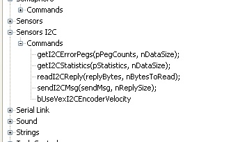

[ATTACH]7817[/ATTACH]
sendI2CMsg(sendMsg, nReplySize);
readI2CReply(replyBytes, nBytesToRead);
These looked promising, figured that we had access to the I2C port for sensors other than the IMEs, alas, they don’t work. I should really say that I’ve been unable to make them work, despite having some clue as to what I’m doing. Even getting them to compile was a struggle as the way they are defined is again “old style” with the sendMsg (whatever that is, does it contain an address? A message length? ) apparently wanting a constant.
bUseVexI2CEncoderVelocity
I assume, but have not confirmed, that this uses velocity data coming from the IMEs in perhaps the PID calculations. It should be a boolean but currently want’s an integer assigned, presumably “1”.

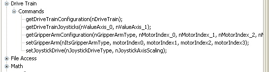

[ATTACH]7820[/ATTACH]
I didn’t dig into any of these yet, looks like they are something to do with simplified standard control of a clawbot or something like that (they are intrinsics unlike the natural language stuff).
