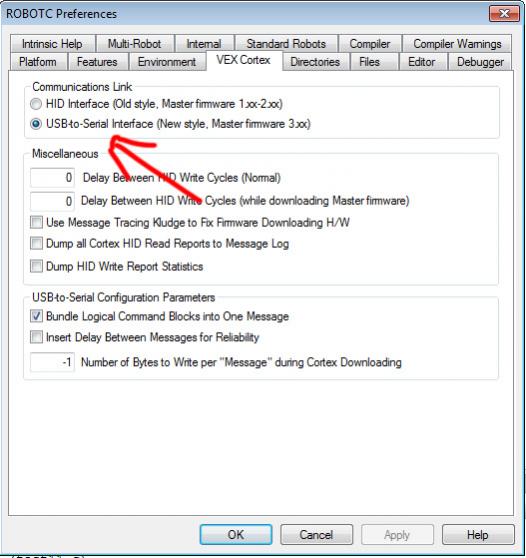

I have a problem where my laptop is running RobotC 2.32, but others are using RobotC 3.0 or later - when the cortex is firmwared to 3.0, it won’t accept any downloads from the 2.32 version. What I end up doing is manually putting the cortex into bootload mode by holding the config button while plugging the usb cable into the cortex (with the other end already plugged into the laptop). This seems to reset it and allows me to download code to the cortex from 2.32 again.
The old firmware setup the USB as a Human Interface Device (HID). The new firmware set the cortex to be a communications device (CDC). They are not that compatible but RobotC V3.XX has a preference to set the communications type.
https://vexforum.com/attachment.php?attachmentid=4924&stc=1&d=1322963152
When you put the cortex into bootload mode it reverts to the old HID USB communications, thats what is burnt into the bootloader code.
