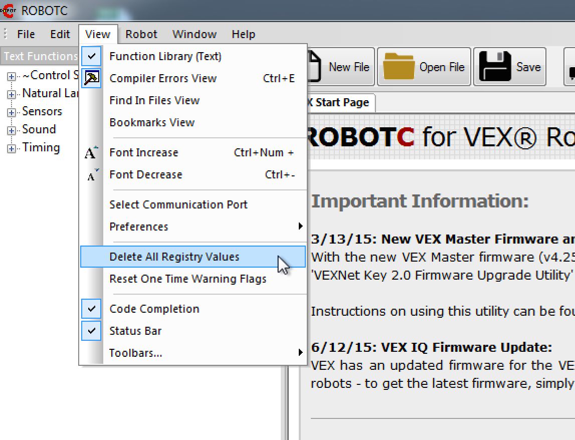

Is there an .ini or registry entry that stores the window layout for the RobotC editor? I have students that keep moving things or hiding windows and I am hoping I can reset the layout on login or at least prevent them from saving the layout on exit.
You can delete all registry values and that will reset ROBOTC back to it’s default configuration.

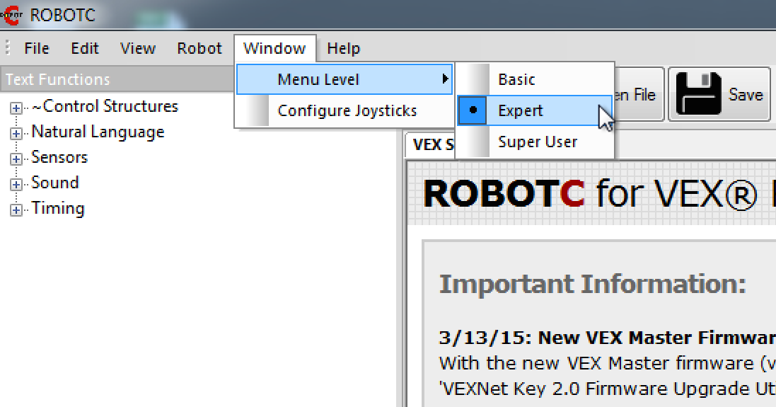

Select expert or super user mode.
Then the delete registry menu item is available.
