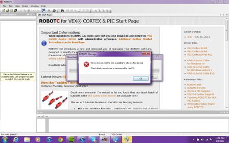

HELP!!! I dont know what im doing wrong if anybody could help me
Can you please tell me what that says? It is very blurry.
No communications link available to VEX device.
Are you trying to update firmware? If so you have to use the USB A-A cable (double male) plugged into the vexnet slot to update.
and i do! yes the firmware
Do you have the firmware installed on your computer? I don’t think it is necessary but it is found here: http://www.robotc.net/download/cortex/
then you need to restart robotC
I also just saw your picture again, it looks like it is requesting admin permissions (in the task bar)
i thought i comes with the software
thats for java
sorry I meant drivers :-D. it doesn’t because it doesn’t know what bit (32 or 64) your computer is. Just install the correct drivers and you should be good.
try this: http://www.robotc.net/support/vex/WebHelpCortex/index.htm#page=getting_started/cortex_firmare/Download_ROBOTC_Firmware_Cortex.htm
Thanks a lot:) ill try this:)
now what???
it still wont work!!
Have you tried it on another computer?
Did it ever work before on your computer?
Try a different USB port on your computer. It sometimes helps.
