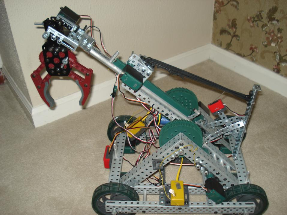

Posted a picture of our robot in the gallery. We are using the design that proved successful in Quad Quandary. Use a 2 link arm to hold tube collector. This gives more flexibility in getting tubes in odd spots. The tube collector holds 4 tubes, we think since we only have 2 to test with. We have alignment pieces to center tubes in our robot. The tube collector stays vertical automatically as arm moves up and down. We toggle the auto poition to just below horizontal to score on both goals. We can also toggle of auto mode to give operator full contol of tube collector. We have a winch on the bot(not in the picture) Still need to figure out a hook and delivery system. Direct drive with encoders to help with autonomos. We have on mode that works in theory. See everyone tomorrow.
