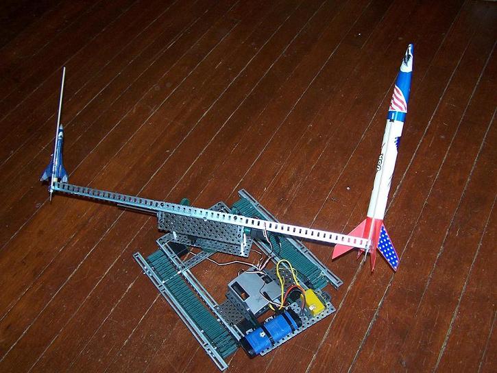

heres my rocket launcher :smiley:
Dude that is beautiful. Awsome maybe u can put it at a less angle. Anouther this put the turning pad up more and bring the rockets closer. the flames will not hit the robot after 4inch so put it up 5-6 less angle rockets closer together and bam the is on man eating machine. It would look sick.

I would go to a store and buy some plate metal doesn’t have to be thick, and place it under the rocket and try and angle the plate so it will direct the exhaust away from the robot components.

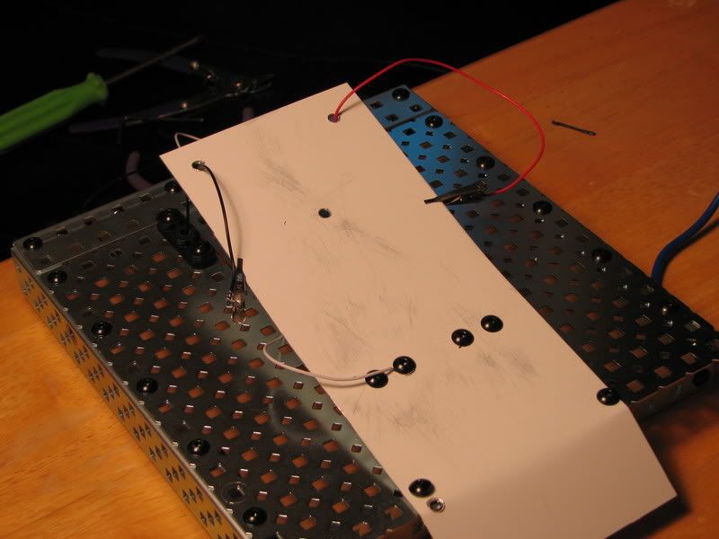

Well then… I wish i had gotten this piece of information before i tried it. I built it, tried it, and had a shower of sparks. Luckily my micro controller survived it. And now i am all out of ideas… back to the drawing board… which i where i should have started… but instead i thought id wing it and build what i thought would work… but that obviously didn’t work… so now i gotta make it work.
I have scrap metal so it is not the matter of that anymore, but now i need a new idea for launching from the same remote. Me new idea, was to attach a wire to the servo motor, and when i press a button on Ch. 5 of the remote, the wire is moved down and touches the 9v battery i will have mounted, and when i release the button, the servo motor will center itself and remove the wire from the 9v battery.
I was also planing on getting Tank Treads and using those instead of wheels, would the engine exhaust have any affect on those once i have the angled board in place? I am going to mount the board so towards the front, the board is high, and at the back i am going to have it hang off a bit so it is a few cm of the ground.

So this is what i have done so far…
[http://i110.photobucket.com/albums/n120/MRClark32493/VEX/VEX012.jpg?t=1168820479
The Red wire is the positive feed to the fuse.
The Black wire is the negative feed to the fuse.
The White wire is ground on the metal platform.
And the Razor Blade under to it, hurts very much.
Would this work? The wire are going to come pout and when the servo motor turns, it will connect one of the wires to the the 9v and ignite the engine.:D](http://i110.photobucket.com/albums/n120/MRClark32493/VEX/VEX012.jpg?t=1168820479)
A 1/2 in plate?! Do you know how much that would weigh and cost also thats extremely overboard for any model rocket. All you should need at the most is 1/4 in and thats even pushing it. You don’t have the engine directly above the plate , the plate is just to direct the exhaust away from touchy stuff. The plate should be 2-3 in from the end of the engine.
I’d try 1/8 TOPS. 1/4 is overkill, and 1/2 is WAY high, not to mention expensive if you don’t know where to shop.
Sorry to hear about the malfuncition there! The separate, isolated servo-powered circuit is the way to go. You could even get a switch from radio shack you could use instead of just wires. I’d go for a lever or roller-lever switch- they look like smaller versions of the official VEX limit switches.
Sorry, slight miscalculation!
Just use sheet metal, like 0.040" or 0.060" thickness. Sears Hardware, Home Depot, Lowes should all sell steel sheet metal. It’s a lot easier to use a pair of tin-snips to cut sheet metal than it is to cut through steel plate with a hacksaw, bandsaw, etc.
