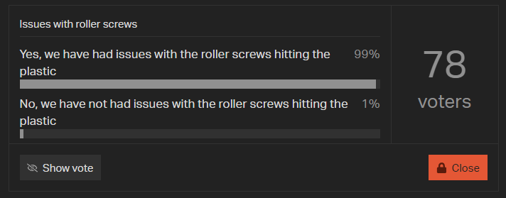

I’m curious to see if any other teams have had this issue with their fields:
Issues with roller screws
  • Yes, we have had issues with the roller screws hitting the plastic
  • No, we have not had issues with the roller screws hitting the plastic

I think the poll at the top of the thread answers your first question:
