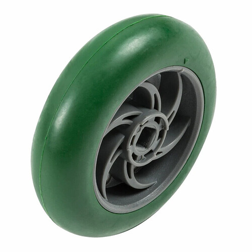

What do the old traction wheels look like? I don’t know if we have them.
