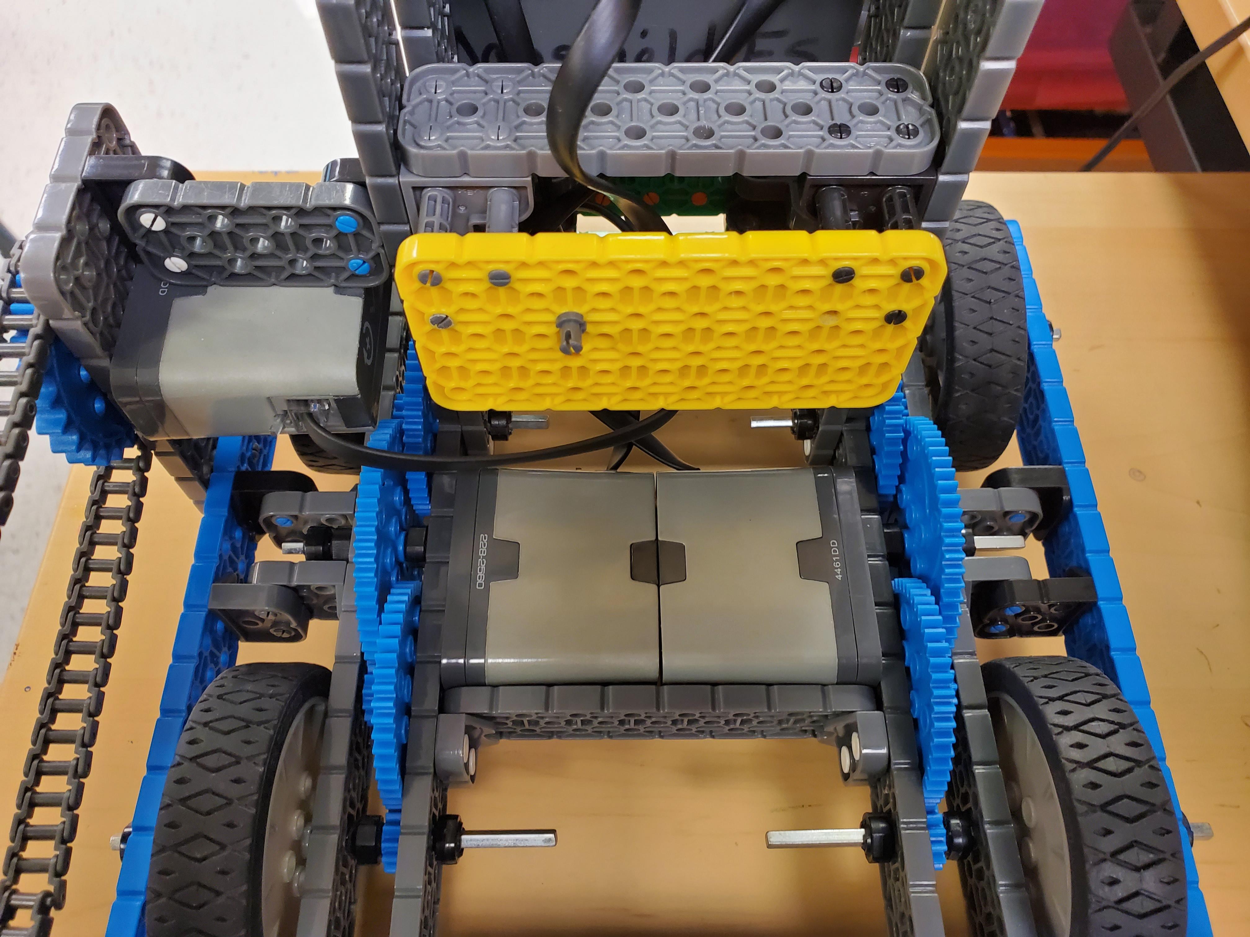

So my little 3rd graders geared their bot with 12 tooth driven gears and 60 tooth driving gear and two 24 tooth idle gears. The motors are in the center. However each side is turning in opposite directions so the bot can’t drive. Is there a way to reverse one of the motors? I don’t know enough about this to help them out.

still not working. here is a pic of what they have done.20201014_130315

Separately, I would strongly suggest massively gearing down your drivetrain as the wheels will go really fast with almost no torque. From the picture, it looks like your robot will not have enough torque to even drive really with the size of wheels that you are using and the friction in the drivetrain.

They are going 60:12 or 1:5 (every time the big 60 gear turns once, the little gear turns 5 times. The 24 tooth gear isn’t an idler gear, it’s on the same shaft. So it’s a 24:12 or 1:2. So you really have a 1:10 drive. At full speed (100 RPM) the wheels will turn 1000 times. So it’s going to be pretty fast as @Noah10851B points out.

Ohhh, I think I understand now. So you mean each side is turning in opposite directions as in each wheel on each side is turning in opposite directions, like the wheel in the top left and top right go forward while the back two go backwards? If so, this is because of the amount of gears you have in place. If you have an even number of gears connecting the two wheels then that means that the two wheels will move in opposite directions. To fix this, you would need to add or take away one gear. I would recommend taking away one because as other people have pointed out this would be very fast with little power.
Also, I can’t tell from this angle but at the top of the picture is there another gear that the big gear is connected to? If it isn’t and the wheel is attached to the big gear then it would also move at a different speed I think.
