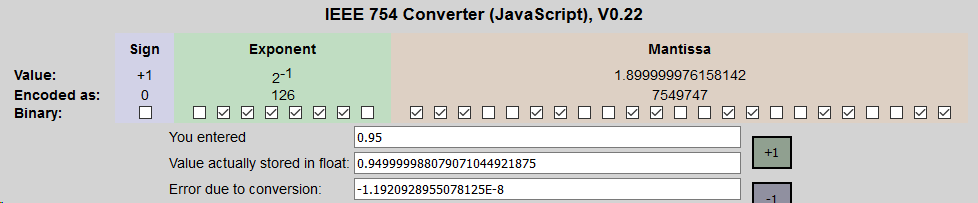

Hi, how do I display a rounded float on the V5 brain with RMS Python? Tried this simple code and it displays 0.949999. I want it to display 0.95. Thanks!

I messed around with this tonight - I think it’s the old Python 2.x problem with representing floating point precision in binary. There’s a Decimal library that solves it, but we can’t include random libraries in RMS.
A possible compromise is to convert it to a string and just print off the string to the number of characters that corresponds to the decimal length you want:

round()'s strange behavior here is a fun result of how that builtin function is implemented: it takes a float as an argument and it returns a float as its result. And, as you’ve guessed, 0.95 can’t be represented in floating point, since you can’t write it out as a binary fraction:
This oddity is noted in the official Python reference documentation:
The behavior of round() for floats can be surprising: for example, round(2.675, 2) gives 2.67 instead of the expected 2.68 . This is not a bug: it’s a result of the fact that most decimal fractions can’t be represented exactly as a float. See Floating Point Arithmetic: Issues and Limitations for more information.
Floating point precision display issues are in every language that uses them, including C and C++, but you can usually work around them with format strings. Unfortunately, those are not implemented in Pymite. @WillRobinson’s workaround is the best one I can think of.
