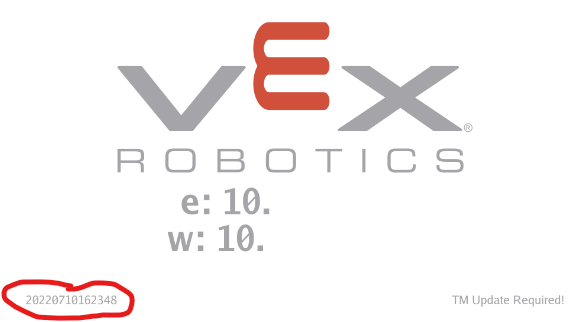

Should this still work? I tried it on RPi and it gave a not found error. The issue I am having right now is that I have a field monitor connected with an HDMI to VGA adapter cable. If I boot the pi with the video cable plugged in, it will redirect the audio into the HDMI output, so I can’t get audio out of the 3.5 mm jack. If I boot the Pi without the video plugged in, I can get audio out of the 3.5 mm jack, but when I plug the video back in, I get an improper aspect ratio on the monitor. Normally to fix that I would reboot the Pi with the video plugged in, but that would be back to where I started with audio.
It worked for me at my tournament in mid-December
Are you sure you’re running the most recent base image? This is part of the OS image, not the TM software which gets updated from within TM.
I am not sure of that. I was using equipment that was not mine, and I don’t know what version of the image the Pi’s were built with. I will try it with some that I know were recently imaged this week, but it is likely that the ones I were using were just running an older image. Thanks.
So, I find myself without and audio again after updating the base image on my Pis. The audio settings on the web interface are set to the 3.5 jack, and I also tried putting the ignore parameter in the config file and the audio continues to only be transmitted out of the HDMI.
Any ideas to get game sounds back to the 3.5" jack?
Thanks

Hi all,
Thanks for bringing our attention to this. It looks like the Raspberry Pi OS changed the way the audio devices work, so that now they’re treated as 2 separate devices rather than a single device with 2 outputs. So, the code that was being used to select the output no longer works (obviously). We’ll have to make some changes to account for this to make audio selection work again. We’ll let you know when we have something ready to try out.
This update should enable you to select the 3.5mm audio output again. Unzip the file and run the .EXE (Windows x64 required). Fill in the IP address of your RPi and click Start Update. After 10-15 seconds the Pi should reboot and you can visit the audio page. If you have a new “Play Test” button then you know the update worked.
Make sure you are using the most recent RPi base image before applying this update:
Let me know how it works.
