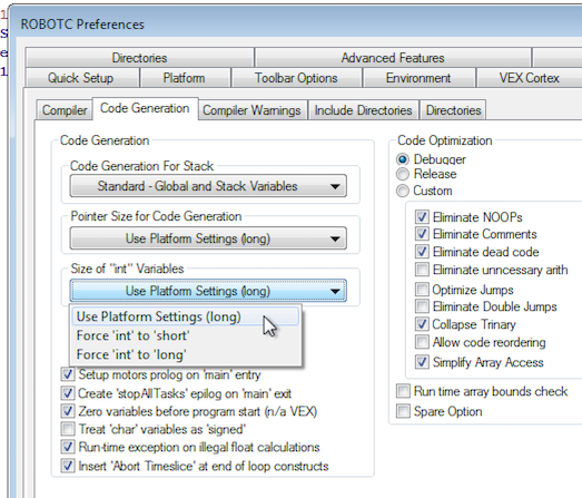

Not sure what you are all seeing, SensorValue will return an “int” which is 32 bits with RobotC set to default settings. The sensor debug window only displays as a short (which I guess is a bug, long ago RobotC used 16 bit ints and this is left over from that) and you will see the value jump from 32767 to -32768, however, the value that you read in the code does not do that. Try this program, you will see values keep incrementing.
#pragma config(Sensor, dgtl2,  enc,            sensorQuadEncoder)
task main()
  while(1) {
    writeDebugStreamLine("%d", SensorValue[enc]);
    wait1Msec(1000);
OP, which version of RobotC do you have?
Just as FYI, this is where you could force an int to be 16 bit (ie. short) in RobotC V4, we did this for compatibility with programs written using RobotC V3.
