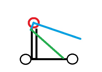

We have a simple arm (see above) on our Sack Attack robot and while it manages to raise about 7 sacks with ease, it begins to struggle as we go higher. The gearing is already very high in torque and we are already using 4 393 motors on high torque mode. Is there any way to add rubber band assist to a simple arm like this in order to allow us to lift more weight? If so, how?
Thank you in advance for your help!

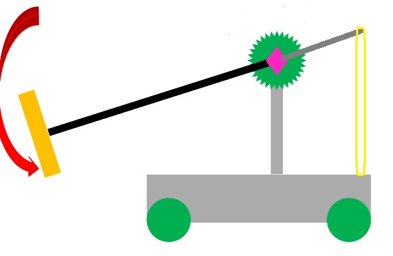

The easiest was would be to add a standoff on the arm and on the back of your upright (gray in the picture) then run rubberbands (orange) from one to another, making sure they go over the back of your arm. This picture shows it better than I can say.
You could use a longer bar for the arm, extending the back (gray bar), and attach a rubber band in the back. If you raise the bar (so the gray back is as low as possible) when you tie on the band, you’ll get maximum tension (upward lift). Optimally, you want just enough tension so the weight of the lift (unloaded) keeps the arm down initially, but when the arm is “pushed up”, it stays put. This video and document also give more detail.
We took a short piece of angle and made the channel an “L” shape at the pivot point and then used standoffs to connect the rubber bands. We essentially doubled our lifting power and with the rubber bands placed in this location they provide more help throughout the entire lifting process. We have our robot apart at the moment or I would take a picture. I will get you a picture later today. below is a jpg file I did in paint to illustrate what I am talking about.
