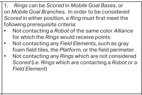

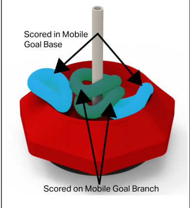

hey, i was looking in the rules and saw that the scoring rules were saying one thing but in the example they give, they say something completely different.
^ in order to be considered scored, a ring cant be contacting rings which are not considered scored

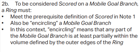

^ in order to be considered scored on a branch, it must be encircling the branch
^ yet these rings are considered scored even though they are contacting rings that are not scored
Asked and answered in the official Q&A
https://www.robotevents.com/VRC/2021-2022/QA/878
how do you get to the Q&A? is there a link in the vex website?
In the Q&A they clarified this was for the sake of showing what encircled means in the context of the game.

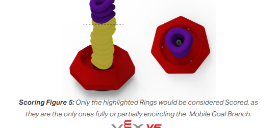

I think the Q&A answer misapplied the rules here.
2c: If a Ring meets the definitions of Scored for multiple
point values on the same Mobile Goal, the highest
point value should be used.
Counting the lower rings as scored “On” the branch causes the upper rings to not be scored, which descores the lower ones, so they count for zero.

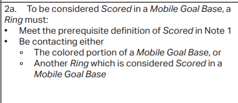

But those lower rings are also “in” the base! Counting the lower rings as scored “in” the base makes the top ones also “in” the base by transitivity, for one point each!
2c says to take the higher of those two options, so it’s one point each.
The fact that “scored” and “unscored” are both transitive makes for some weird and possibly indeterminate edge cases. I think they should change 2a so that the last point reads “Another Ring which is considered Scored in a Mobile Goal Base or on a Mobile Goal Branch.” Then the lower rings count for 3 and the upper ones count for 1, which to me is the common-sense interpretation of the situation.
That is the through line for nearly everything in Tipping Point.
I concede that one could make a reasonable argument that rings stacked above the branch are worth 1 point, along with all below. However, given that G22 elevates the Official Q&A as an extension of the Game Manual, there is definitive proof of how the GDC wants these scored.
they would not be considered scored in the base because,
as per rule 2a, they must be contacting a ring that is considered scored in the moble goal base.
rule 2c says that it is considered scored on the branch, meaning they are not considered scored in the base.
so, the Q&A had applied the rules right
I think what @dfergemann is suggesting is suppose one were to remove the Alliance Branch entirely. The stack of rings (including those which would be above whatever the height of the Branch is) would be considered 1-point scored. The bottom Ring touches the colored portion of the Base, and then each above would also be 1-point.
Again, given that the Q&A officially says these are worth zero points, resolves this philosophical discussion
