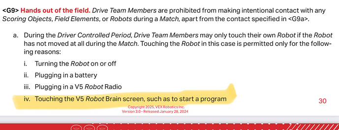

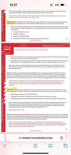

One of the programmer’s at a competition last week was told that he couldn’t press the brain to run his program for skills. He was confused because that is an option in the block language for V5. Also, the game manual is not clear. He’s new to V5, but has IQ experience. He was used to the touch LED light in IQ. Any feedback would be appreciated to give him feedback. Thanks
Key words in G9 is “During a Match”… Match does not start until Autonomous is activated.
Prior to match, robot is disabled from receiving any input from V5 Controller, but it is permissible to press V5 Brain to configure, and it is permissible for V5 Brain to send information to display to Drive Team via V5 Joystick Controller. Motors are disabled.
