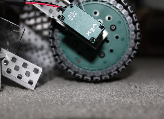

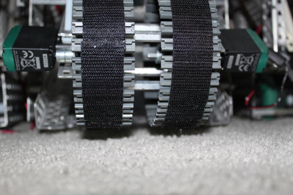

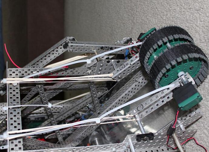

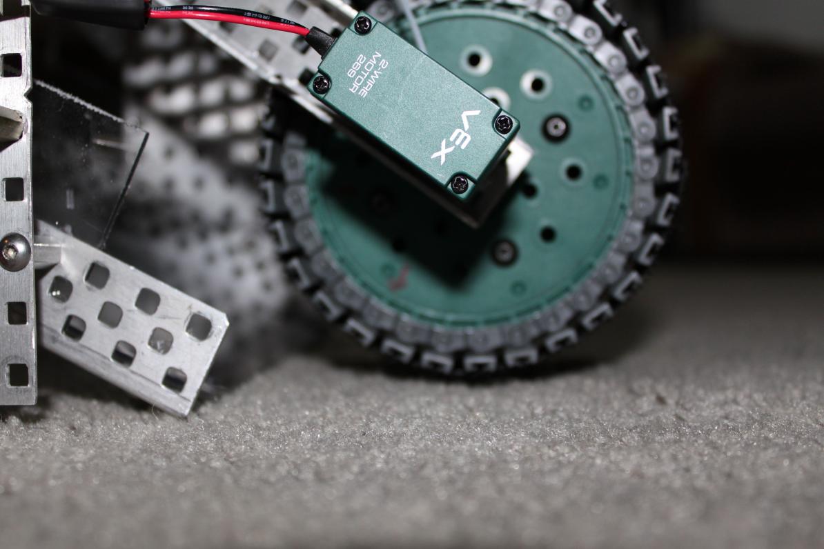

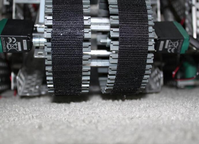

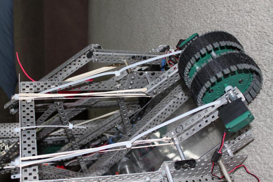

So this is our first iteration for our 2012-2013 Sack Attack design. We just made a few changes on the intake from our gateway robot.
The intake mechanism is on a pivot so the zip ties make sure the mechanism does not hit the ground and the rubber bands help the mechanism stay down.
This looks really interesting. I’m assuming that since this was your gateway robot you are not capable of going under the troughs. Either way, if this intake works as well as 4886’s this could be the first fully functional sack attack robot. Congratulations!
The intake mechanism used here seems quite interesting in that I imagine sacks will never get stuck, as happens when using the legs. Have you tested this out with some amount of sacks? If so, around what number of sacks can be intaken/lifted?
So the velcro grabs the sacks well? Do you have a video of it intaking?

We have not tried using actual sack because we do not have any yet, but we have tried using duck canvas (which is the material the sacks are made from) and the velcro works nicely. There are still many changes to be made to the rest of the robot as we just changed the intake from our gateway robot.

how did you stick the velcro onto the tank tread?
I found duck canvas on a blanket, you can find it on some common household materials. We still have not tried using actual sacks because they are sold out.
