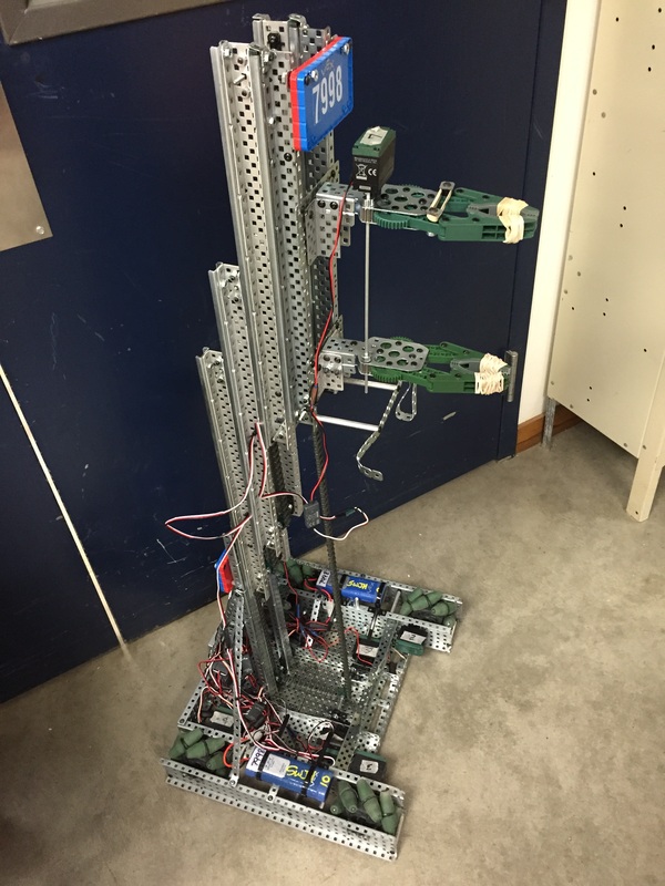

@sagar97 Wiring on Moving Platforms
To wire anything moving, you’ll need to make sure your wires are long enough that they can stay connected for the whole range of motion. In other words, you need a lot of slack. Then you need to make sure that all the wires connected to the platform are connected in one bundle with zip ties or something. this makes sure they are neat and do not get tangled.
use cable ties in between your connections so they dont come loss or disconnect.
I usually make something similar to this:
Just make sure that you check all ranges of movement when you’re done, to make sure nothing is getting damaged or caught

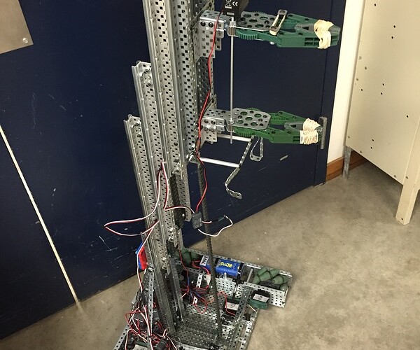

My skyrise robot had to accomplish that.
Our’s looked similar but with a plastic tube holding the wires from the lift.
Here is a video view.
Out of curiousity how are you controlling the motion of your sliders in the sky rise robot(i mean by dc motors or by using the stepper motor). How and when does your robot know to clutch that yellow thing.
