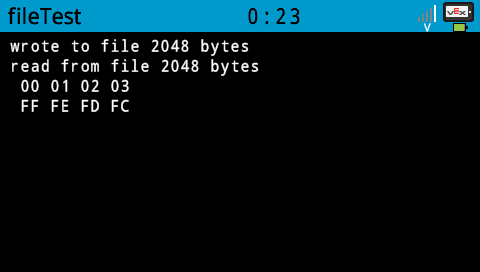

Here is another example.
code
#include "vex.h"
using namespace vex;
uint8_t   myarray[2][1024];
int main() {
    // Initialize some values in the array
    for(int i=0;i<1024;i++) {
      myarray[0][i] = i;
      myarray[1][i] = 255-i;
    // save the array
    int nWritten = Brain.SDcard.savefile("test.bin", (uint8_t *)myarray, sizeof(myarray));
    Brain.Screen.printAt(10, 20, "wrote to file %d bytes", nWritten );
    // clear array
    memset(myarray, 0, sizeof(myarray));
    // read back from file
    int nRead = Brain.SDcard.loadfile("test.bin", (uint8_t *)myarray, sizeof(myarray));
    Brain.Screen.printAt(10, 40, "read from file %d bytes", nRead );
    // show some data we read
    Brain.Screen.printAt(20, 60,"%02X %02X %02X %02X", myarray[0][0], myarray[0][1], myarray[0][2],myarray[0][3] );
    Brain.Screen.printAt(20, 80,"%02X %02X %02X %02X", myarray[1][0], myarray[1][1], myarray[1][2],myarray[1][3] );
This initializes a 2D array with some non-zero data, writes the data to a file on the SD card, clears the 2d array to 0 and then reads back the data it wrote. Finally, it prints some data to the screen to verify it was written.

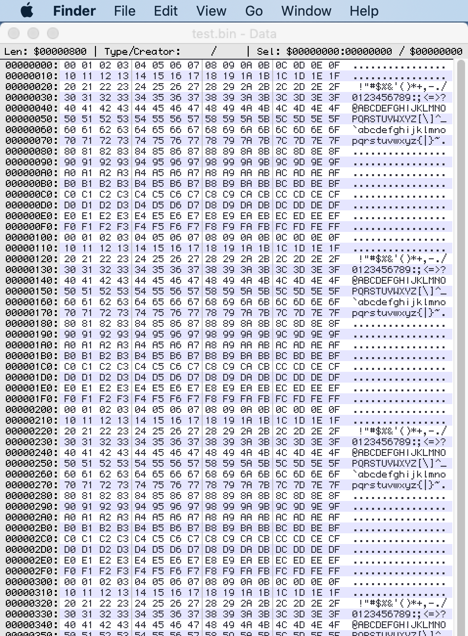

filetest
The array I used for the test was 2048 bytes long (2 x 1024) so the file on the SD card should be of that size, remember this is just raw binary data, there’s no formatting into human readable strings or anything. If you looked at the file in a hex editor it would start like this. Your file will obviously be different.
