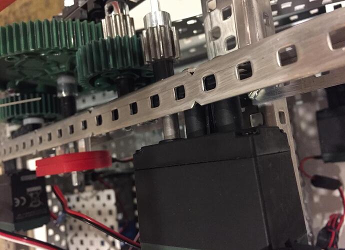

My Lift is a 1:21 4 stage scissor lift, and the axles that connect my 36 tooth gear and 12 tooth gears keep on bending. All the gears are between 2 c channels. Is there a way to solve the bending?

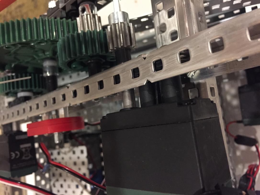

Here’s a photo of the 1:3 part of the gearing. I also forgot to mention in extreme cases the axles twist also.
On any lift where you have a really high-torque gear ratio (compounding, 15:1, 21:1, etc.) the axles are under a lot of stress. There’s bound to be some bending, especially if the places where the axle is supported are far apart. It looks like you have almost 2 inches of space (I calculated 1.875") between the two c-channels, which almost definitely will result in bending. Try cutting that down (putting shaft collars and bearing flats on the outside, taking out spacers, etc.). You can also switch to high strength shafts, which are made for high torque applications.

I would personally just change the power reduction ratio. instead of the 1:3 section. chain a 1:2 and keep your 1:7. the extra power dosnt do you much good if it is being put into candy caning an axle. you will also be faster.

A 21:1 should not twist axles unless something is wrong. Are you using elastics to counteract the weight of the lift and intake? I don’t mean a few, our scissor uses around 50 #64 rubber bands through out the tiers of the lift.
A larger picture of the robot might give some more context and let us look for more issues.

The two biggest culprits of shaft twist are the distance the load has to travel on the shaft and the size of the shaft itself. If you want the true math and formulas behind it just ask.
But you have two options to fix it:
Reduce the shaft distance from the force input part to the driven part. The shaft has to try and not twist over this distance.
Go with a bigger shaft. This is new this year but it is sometimes not feasible like when dealing with a 12 tooth shaft. Another way of dealing with it is putting more 12 tooth gears along the shaft to not allow them to twist. This almost effectively increases the diameter of the shaft. The shaft profile has a larger contribution than the distance. So changes to this have a greater impact.
The third option is not legal in the game which is change materials to something stronger.
For bending, the amount of support points and how much clear distance between supports are your culprits. More bearing blocks and building out little support structures in the middle help a ton. Don’t let that shaft bounce about.

What I meant, was that I’ve seen plenty 21:1 scissor lifts that haven’t had this problem(have counteracted it so it wasnt an issue). I dont think 21:1 on a scissor lift is a faulty design that will always twist shafts, so I figured it must be something wrong with this specific implementation, which led me asking for more pictures. What we’ve seen so far is relatively solid and of high-build quality, so assume for the problem to persist there could be a problem somewhere else. I wasnt saying 21:1 is less prone than a 15:1 or a 7:1, but it still shouldn’t twist if done correctly.
Until OP says I’m wrong, I’m strongly leaning towards them not using enough elastics and lifting a whole lot more load than a usual scissor.
I can provide more detailed pictures when I work in the robotics lab tommorrow, but I have a youtube video showing me doing skyrises before the axles started messing up. I will add more elastics (thanks 400X) and I’ll see how it goes tommorow.
