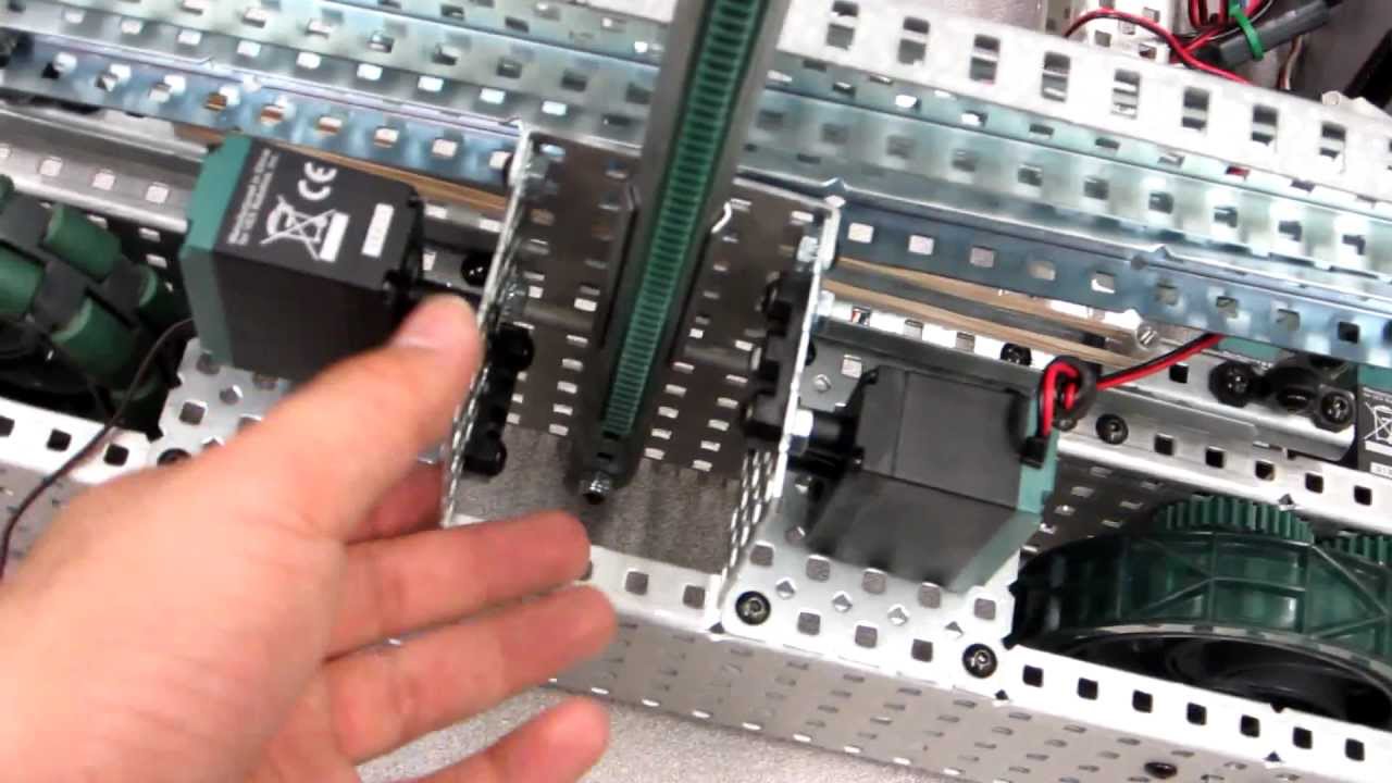

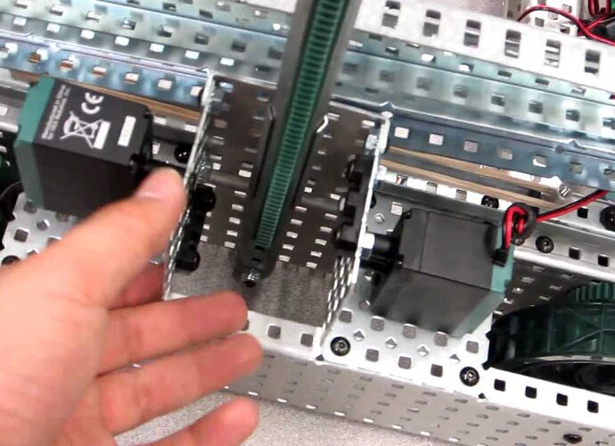

[ATTACH]8383[/ATTACH]
Also I believe the angle they are talking about with the level to the ground is the bottom bars when it is lowered.
[ATTACH]8384[/ATTACH]
With the vertical linear slide powered lift in the top picture. I’ve had a team member in my club that built one of these and it constantly shredded the rack gears. Later they even made it so that each side bad two sets of the linear slides to spread the load with the same result.
Now they might have done something wrong but it was a terrible experience for them.

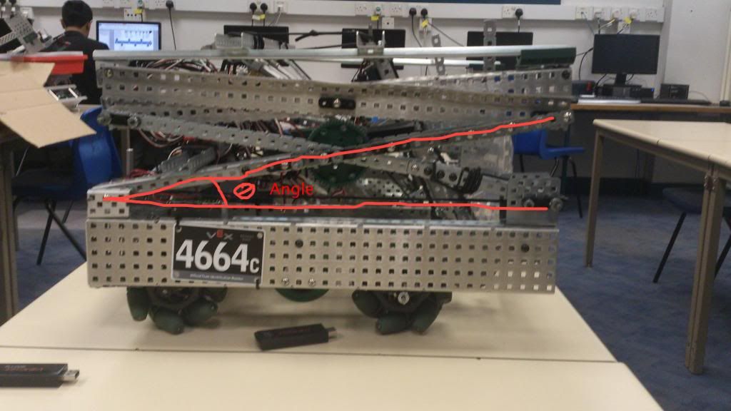

Just to clarify, here’s a sketch on my team’s first toss up scissor to show what angle I was talking about in my post above.
Something else to note-as the angle changes, so does cos(theta). So while at the bottom of the lift you might need cos(25)Fd torque (if your angle is 25 degrees) somewhere near the top you would only need cos(75)Fd torque. If you check what cos(25) and cos(75) are, you find that you need significantly more torque at the bottom than the top. We utilised this fact in our six bar to get 2 motor 1:7 low hang.
