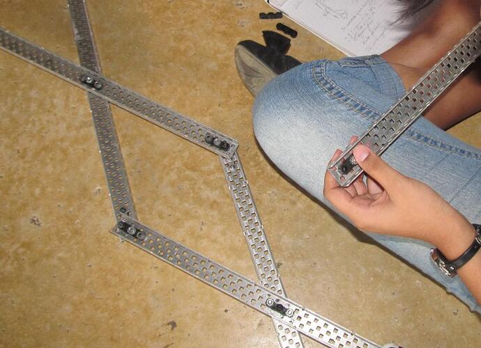

What do you mean with 2-4 bearing blocks?
Do you mean 1 bearing on each side of a C-channel (for example), and then you have a total of 4 in that joint?
We use 1 on each end. …like in this picture: [ATTACH]8768[/ATTACH]
Yes, that looks good.
I think by 2-4 he meant to stack 2 bearings in top of each other, but I would not recommend that because it will be very hard to align them, and the increased friction from misaligned bearings will outweigh any small advantage.
With your design, that is all that can be done. On my scissor lift however, i have 3 c-channels, so i have a bearing block on the outer c-channels, and two on the inner most. [ATTACH]8770[/ATTACH]
This is about a month old, and there are only bearings on the middle c-channel, but i hope now you can understand what i meant when i said “2-4 at each connection”.
