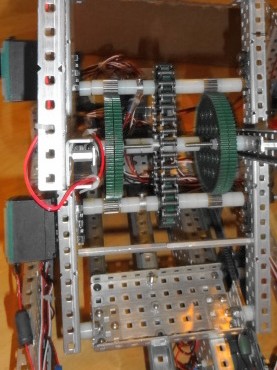

Last summer, I decided to mess around with a scissor lift I over-reinforced everything, but it worked. I started by powering the slide, but it didn’t move, even with 2 HT motors. This worked much better.
https://vexforum.com/attachment.php?attachmentid=6709&stc=1&d=1346374935
The chain and four metal gears was very heavy-duty, but the gear never skipped once.
