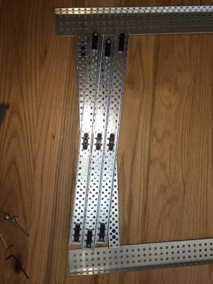

Yeah we have the long linear slide right now with the small inner slide with the rack gearbox bolted to them so they can be the thing that the c-channels are attached to. But the problem is that the small inner slide wobbles so that causes the entire lift to wobble. Any idea how to fix that? Besides that the actual scissor part is very stable.
Also attached is a picture that can kinda show what we have so far.

I think it looks very good. At this stage it will wobble a decent bit, no matter how good it is built.
I would keep going and build the second side, and then attach the two together at multiple stages. If it still wobbles too much you can then see how you can possibly improve the joint and other parts.

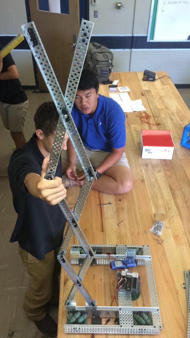

One idea that may help to counter a side to side wobble would be to connect the two individual scissors with a few crossbars. By attaching a bar that connects the two scissors together, you can limit the amount of flex that either one has when it sways to the side. I would suggest something similar to how the bars are mounted on the robot in the attached.

Cross bracers between the two sides is key. think about including a 3 sided lift to completely eliminate side to side movement.

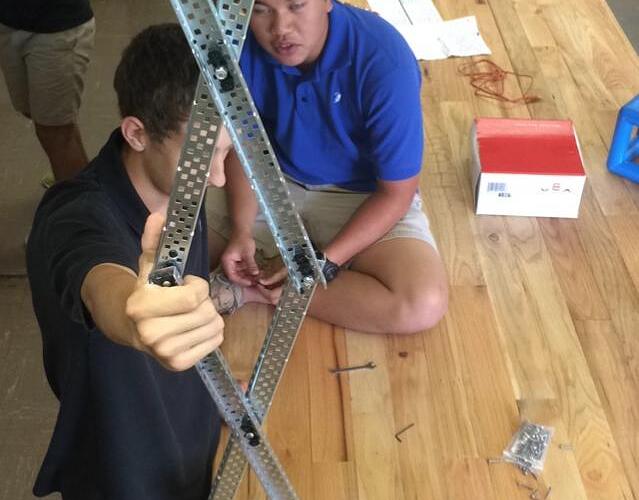

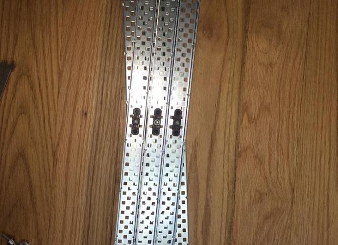

Ok thank you people, YALL have really helped a LOT! Now we found another small problem [ATTACH]8566[/ATTACH]
If you look at the picture you will notice that we had to stagger the c-channels because there is not a hole in the definite center. We thought that would solve the problem, it did, but that also caused it to be longer than 18 inches. How have yall positioned the c channels so that that are all even, it’s under 18 inches, and all the different sections lift equally?
Or will I have to just cut off like 1/2 inch on each bar to make it work correctly?
There are 34 holes on the central line of holes and 35 on the other two lines of holes.
Usually the longest bar we use in VRC middle/high school is 35 hole, 17.5 inch bar, because it fits into the size limit pretty decently.
If not getting the central hole is annoying you really much, try switching to outer lines of holes, which is what most of us would do.
We tried doing that but when we extend the scissor lift, all the sections aren’t even. As in one fully extended and another still has a slight gap in it. Or if we have it so all the sections are equal it will not collapse correctly. We may be doing it wrong, but we aren’t quite sure! Any hints?
It’s a very easy fix. Simple don’t use one of the holes at the end, making the section you are using 33 holes long instead of the full 34 that are in the middle. You can then cut the end off, but I would keep it so you can use it when the robot is taken apart.
What I mean by that is that you can just use the following holes:
-Far Left
-The hole that is slightly to the left of true middle
-The second last hole, one in from the right.
And mirror/flip this accordingly for other pieces.
