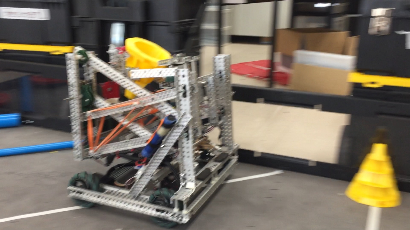

I have a question regarding a scissor lift with a platform on the top. Do you need a linear slide at the top of the lift like the one at the bottom? I am referring to this type of scissor lift. https://www.youtube.com/watch?v=9nujo9A-GUw . Thanks!

A slider at the top is not required to build a proper scissor lift. However, in this specific video, the robots with the scissor lifts have linear sliders at the top attached to the 5 hole C-Channels. I’m almost certain that they have the sliders at the top to keep their cone intake and the 4 bar flat and have it parallel to the ground.

Have u built a scissor lift before? U dont need sliders at the top. Absolutely unnecessary and it adds unneeded weight. Just simply use nylocks to allow the top to stay parallel at all times. Ez.

Im sorry, but I want to build a scissor lift like this one and in order to allow the base at the top to remain parallel, I believe the top platform needs a linear slide (so the lift can move up and down). But, I have never built a scissor lift and I may be incorrect. Could you elaborate on your nylocks design? Thanks!

Sorry, but I seem to be failing to understand how a scissor lift could work without a linear slide. As far as I understand, the scissor lift is a linear lift that stays linear due to its use of a pantograph. We can all agree that in a pantograph, a change in one parallelogram would result in a simultaneous and identical change to all others. How could a scissor lift go up, if the bottom or top parallelograms are restricted in movement?

There are many ways to power up a scissor lift.
Eg.
  1. linear slides
  2. rack and pinion
  3. gears at the centre of the x-bar (my personal preference)
