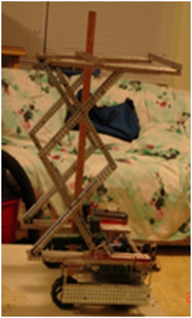

Attached is an example (sorry about all the crummy quality pictures) of our scissor lift robot that could extend 36" (it could go further than the yardstick in the picture)

Hey,
I cant really see alot of the picture because my monitor is small and its hard so I have a couple of questions
  1. What metal Are you using?
  2. What it the Red Part?
  3. How is it sliding?
Please Thanks:)
Sorry about that. I did repost more images in the gallery so i hope that helps.
1: The metal is slotted angle http://www.vexrobotics.com/products/accessories/structure/segmented-angle.html
2: The red part is i think cut slotted angle, we used a part of the rail slot on it. Its just spray painted red (which I would not recommend doing)
3: I wouldn’t recommend this method, I would stick to earlier posts about the Chinese scissor lift robots. But basically its like corpralchee’s scissor lift (i believe). You use a rack and pinion method to drive the end of the scissor lift laterally. I’ll try and post a picture in the gallery. Might work alright with lower loads, but lifting a whole robot doesn’t work out for too long lol.
