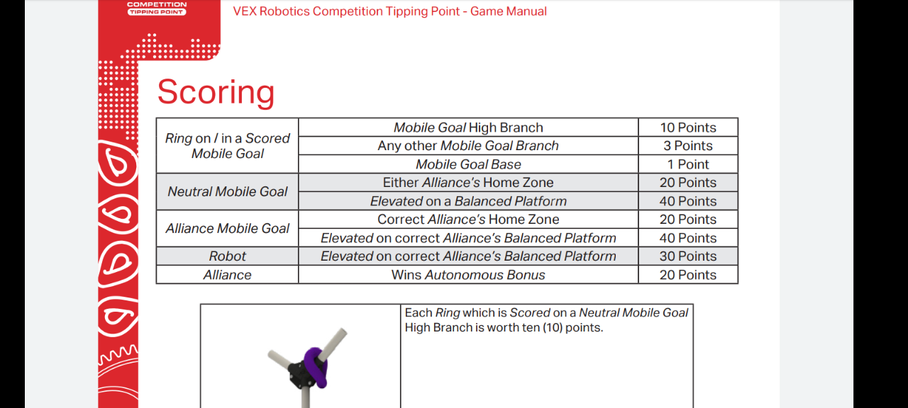

In the scoring section of the game manual on page 17 it’s stated that
“A Mobile Goal is considered Scored in an Alliance Home Zone if, at the end of the Match, any part of the Mobile Goal Base is contacting the Alliance Home Zone.”
and on page 15…
“Each Mobile Goal that is Scored in an Alliance Home Zone is worth twenty (20) points for that Alliance.”
where the rest of the page also does not clarify any scoring at the end of the match even though elevation is confirmed to only be scored after the match is over (and not after autonomous).
Is the only way to score in autonomous scoring rings and not any goals in alliance home zones?
Generally, autonomous is scored as if the match had ended, meaning both alliance mobile goals untouched are each worth 20 points at the end of the autonomous period.

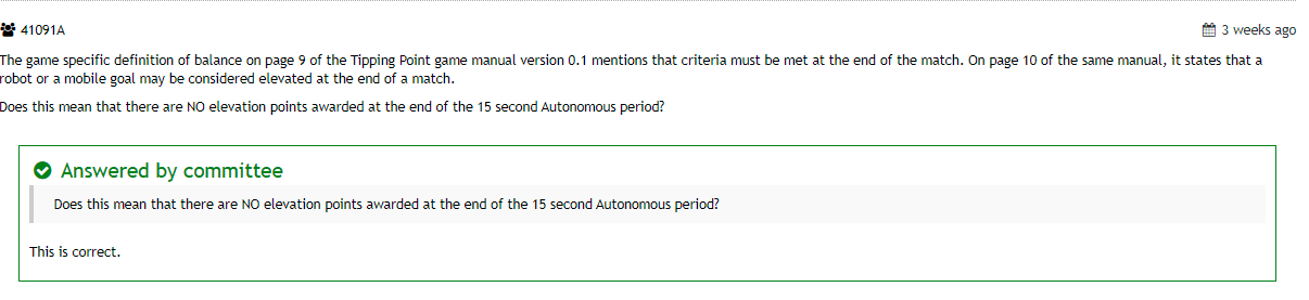

But that definition also goes with elevation which isn’t scored after autonomous? How does VRC differentiate between the two?
By elevation are you referring to parking on a balanced platform?
I’m referring to both parking and elevating mobile goals. In the official Q&A there was an answered question about elevation and mobile goals. I’ll paste a screenshot below.
Thanks for sending that…I was going to post the exact same question earlier… With regards to your question, I would assume everything except parking is allowed during auton.
Thank you. I’d assume the same thing, but I wish there was a definitive way to confirm the scoring.
I, like you, are just a competitor and that’s just my thoughts but I totally agree… I wish we could get an official answer.
You could always send another Q&A to confirm that teams can get the 20pts a goal… although I’ll be very surprised if we don’t.
I hadn’t actually noticed that the definition for a goal in an alliance home zone included being at the end of the match, but since it does we can follow the same logic as elevating goals and robots (which is confirmed to be correct in the q&a) to state that goals are also not worth any points during auton.

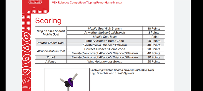

    Screenshot_20210708-190515
At the same time though, it would be weird if every match started off with both teams already having 40 points, so I can kinda get why VEX is doing it this way.
oh wow you’re right. if a neutral goal cannot meet the definition of scored in an alliance home zone at the end of auton, then rings on a neutral goal are not worth any points.

I’m looking through the manual again, and even scoring on alliance mobile goals seem unclear.
5. a. Mentions the end of the match for alliance mobile goal rings. (page 18, under the scoring section)
Alliance mobile goals don’t count for points. Just the rings in them.
I was unclear in what I was referencing. Earlier in the thread we came to the conclusion that the only way to score in auton was by scoring rings on alliance mobile goals. But after seeing this, it seems like even that might not be a viable option (until the REC clarifies auton scoring). Because it specifies that rings that are scored count for the alliance
