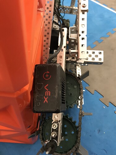

Scoring Help
( we use a top to bottom flip out ) So we have a problem where our intake bends TOWARD each other which causes are motors to “hug” the second cube, which makes it impossible to score. Any suggestions?
I would suggest adding more supports between the arm and the rollers to prevent it from bending and possibly add some tension to pull the rollers out a little bit. Using non-bent metal will also help
if u need a quick fix put a stand of on the side and rubber-band/zip-tie it away to keep it straight
Try moving your rollers up closer to the supports if possible
