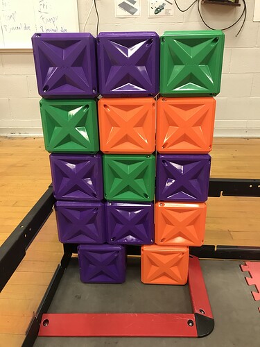

Would this be legal? I’m thinking so since the bottom two faces are flat on the tile, and all other cubes are stacked.
Heres what the official rulebook has to say:
Stacked Cube - A Cube status. A Cube is considered a Stacked Cube if it meets the following
criteria at the end of the Match:
  1. Contacting the Top Surface of a Base Cube or Stacked Cube.
  2. Not contacting the top of the field perimeter wall.
  3. Not contacting the Top Surface of any Cubes which are not Scored.
I don’t see anything that would make that illegal
This would be really hard to pull off in a match though
if its not supported by the field perimeter I don’t see why it wouldn’t be legal just difficult to pull off since your robot would have to be specifically designed to do this
Someone needs to put this in the Q/A because if this becomes legal DR4B’s are going to be better
This is legal. No Q&A needed, all the cubes meet the definition of being stacked, therefore they are all stacked. Its impractically hard for robots to do this though.
