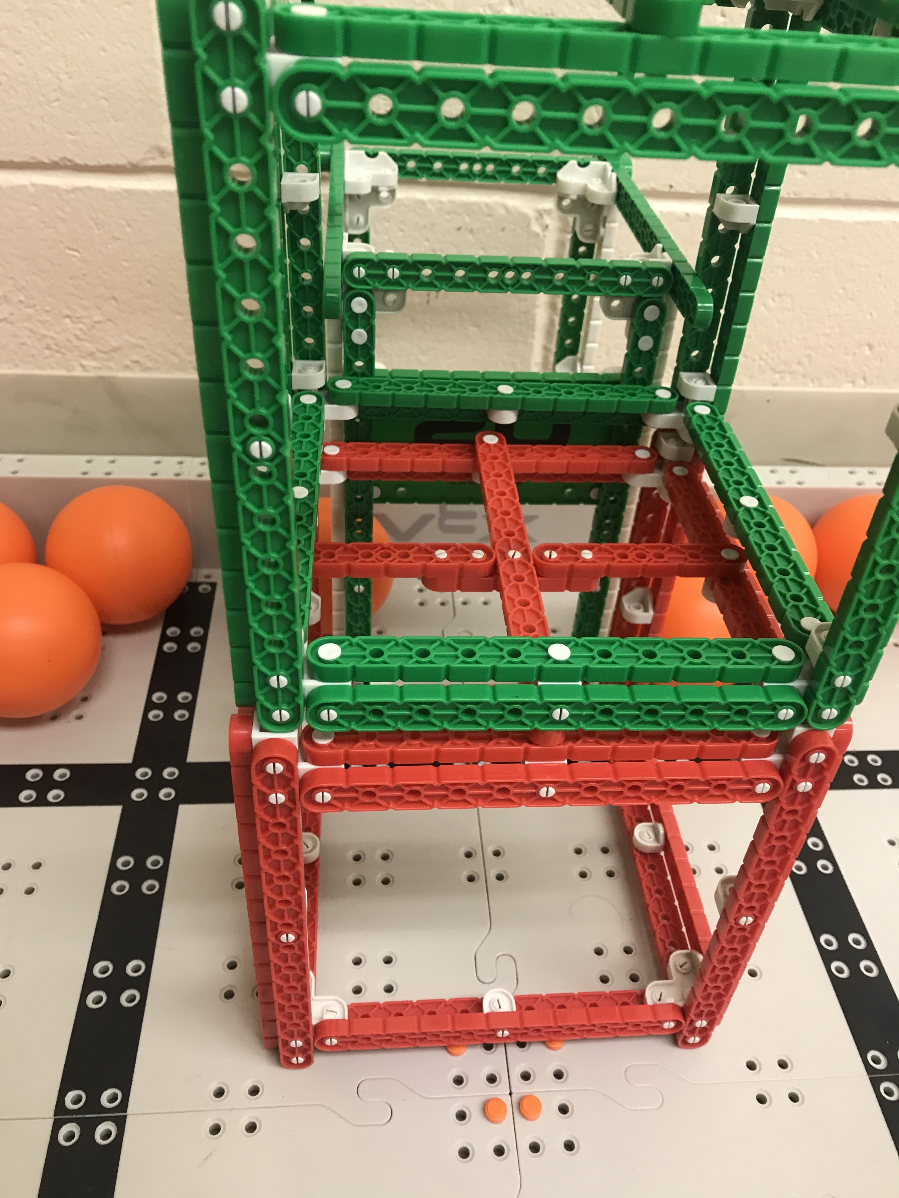

Would this scenario count for the green cube being scored in Squared Away? (New coach question…) In the photo, the green cube is making contact with the platform. Thanks for the help!
IMG_9125
We need to look at the definition of “scored” in the game manual: (https://content.vexrobotics.com/docs/viqc-squared-away/GameManual20190816.pdf) on pages 7 and 8.
the criteria given by the manual for “scored” is as follows:
i. The Cube is contacting the Platform (including its supporting structures).
ii. The Cube is not contacting the Floor.
iii. The Cube is not contacting the Field Perimeter.
iv. The Cube matches the color of the Platform (i.e. is a green Cube).
If the green cube meets all four criteria (in the picture, it appears to meet all four criteria), and it is not contacting a robot, then the cube meets the definition of “scored”. We must be careful not to add additional criteria (like “not touching a red cube”), nor leave off any of the criteria in the definition given in the game manual.
